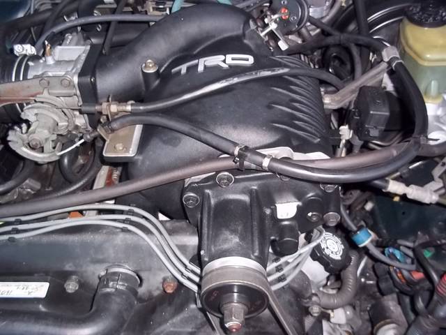

I am starting fresh with a new project and have found a great T4R supercharged in Florida that I want to buy. It has about 119,000 miles on it. No history on when the SC was installed (its the black TRD).

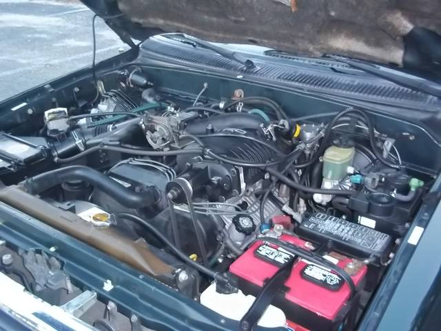

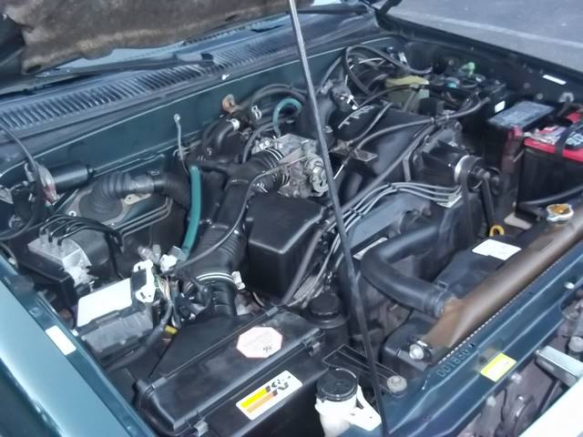

I have some decent shots of the engine compartment, it all looks very clean, but I have NO experience with the install of the SCs and would love for someone to take a look for red flags.
Also, Since I live in Steamboat Springs, Colorado, this thing is probably going to need some fuel adjustment, as I will bring it from sea level to 8000 feet. Can anyone give advice on whether Im getting myself into trouble or not??
Ive also considered looking for a lower-mileage 1999 or 2000 and then putting a NEW TRD SC in it, but am unsure whether it will need the 7th injector or a Fuel/ Timing Upgrade in order for it to run smoothly at higher altitudes.

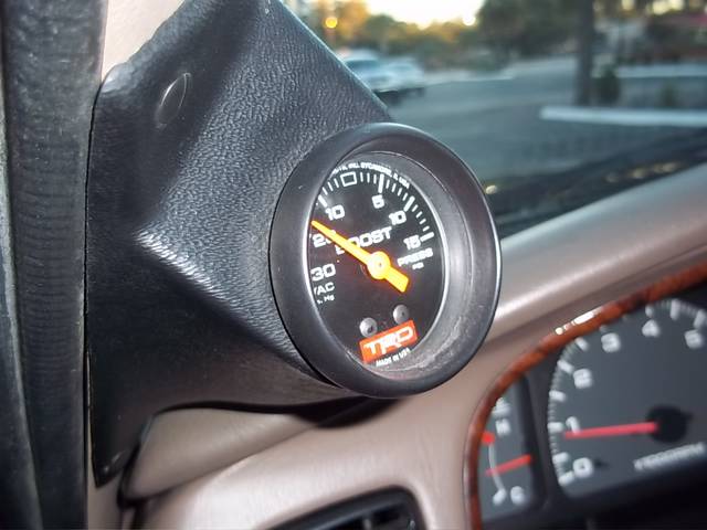

Any advice would be greatly appreciated! Ive attached photos of the T4R Im looking to purchase.

The SC looks fine in the picture, but pictures can only tell so much. I would just replace the oil if the guy doesn't know if it has been changed. Might as well start fresh.

There's no way anyone is going to be able to advise you about the condition of the supercharger, or the quality of the install based on those pics alone. The install is pretty straightforward, and as long as all the vacuum lines, throttle cables, and torque values on the bolts were setup correctly, the install should be fine. If there was a problem, you'll probably notice it if you test drive the vehicle.
