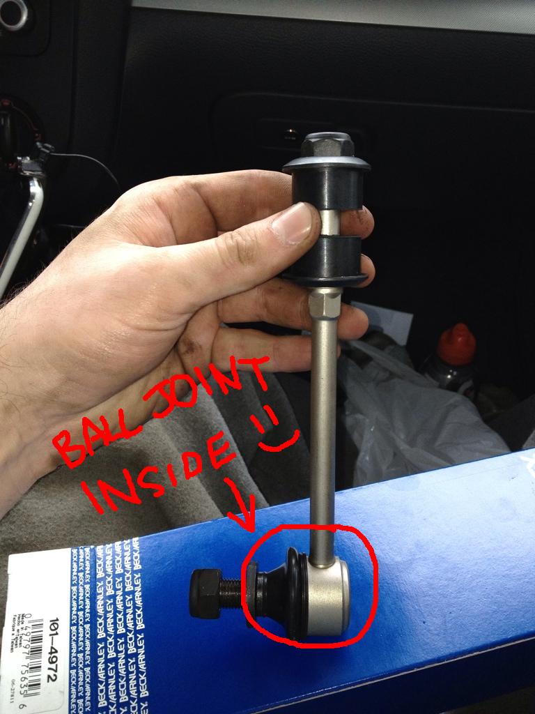

Ah okay. The front has a ball joint right? I'm in Lordco now and the one they gave me doesn't...
Okay this is what I bought.. It's all they had listed for our truck.. Am I returning this haha
a2e953c4.jpg~original
84f600b1.jpg~original
Definitely no ball joint in this one..
