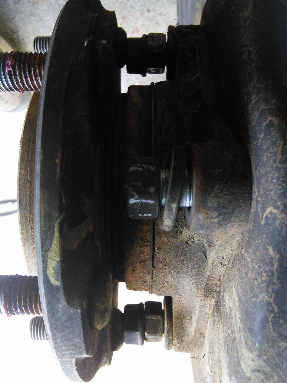

I am replacing my bearing with a complete bolt on assembly and I am stuck at this point. Any advice on how to get this off? The 4 bolts on the back afe completely out as you can see by the pics but can for the life of me get it to slide out.

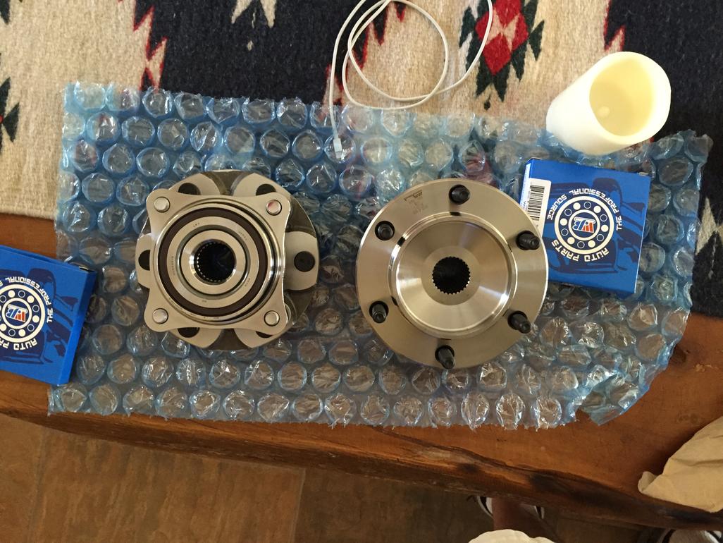

Here are the bew ones I really want to get on... Any advice is greatly appreciated. I have been tapping on it pretty good and hope I didn't cause any damage. Seems like its just jammed on there pretty good..

It looks like you created a nice little gap between the bearing housing and the backer plate. Give the axle shaft a couple soft whacks with a rubber mallet to make sure that the splines aren't stuck. Then wedge a flat head screw driver into that gap between the hub and backer plate. Once the screwdriver is in there you should be able to twist the handle of the screwdriver (don't use it like a lever, actually twist it) to put a little outward pressure on the hub. Just work it out little by little and make sure it comes out straight by working opposite corners of the hub close to the bolts.
There's nothing but friction and time holding that hub on.
Agreed. I just did this job myself. I'd removed my axles a little over a year ago to reboot, so mine weren't stuck. As mentioned, just keep working it. The splines on your axle shaft coming through the hub is likely the sticking point. Work it into submission. A little wd40 or penetrating oil might help you.

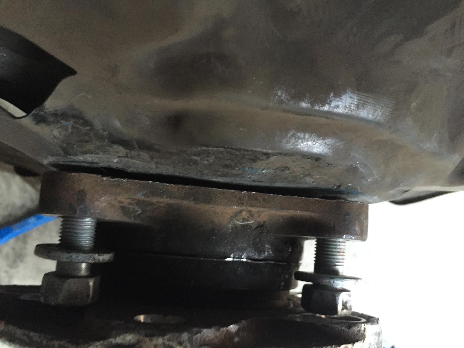

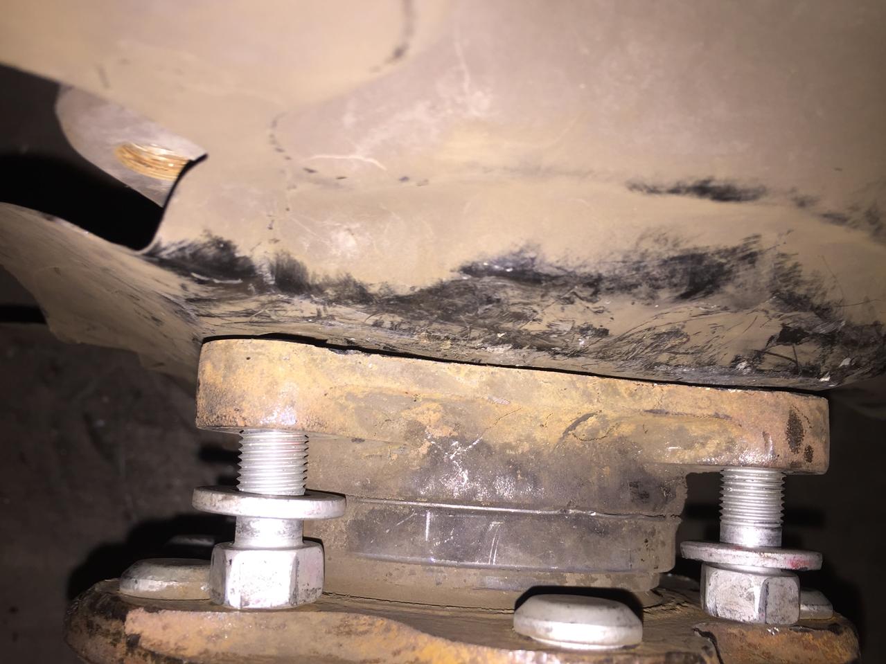

This is a simple press out technic. 2 nuts as you can see using as a spacer for your bolts in the back to add force to push it out.

Guess you didn't use the spacer and your own bolt for leverage, works slow, but, pushes right off.

I am going to give your method a try on the other wheel tomorrow. Sounds like it may be alot easier then all of the pounding witht the chisle I did today.

Hey you old fart, your idea is nothing short of brilliant. I still had to use a chisle only because I did not use a thick enough nut. Otherwise it slowly but surly worked that thing off and then a few whackes with the chisle and hammer and I was golden. Thanks for the idea, I highly recommend it to anyone doing this job.
