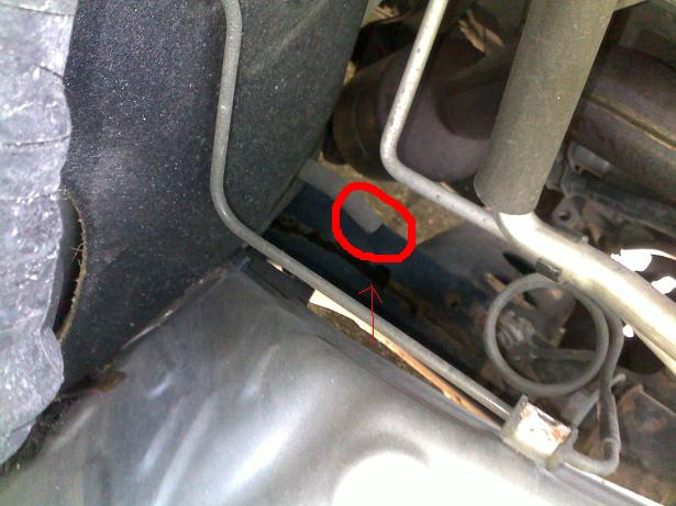

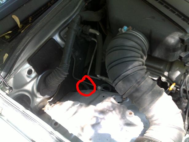

Hey so today thefirst real hot/humid day of the year in Chicago and after driving my runner a few blocks and parking it after having the a/c on I noticed a bit of what seemed to be(looked and smelled like) water dripping from the rear of the engine bay on the passenger side of the car behind the wheel, I looked under the hood and noticed this tube coming out of the firewall where it was coming from(in pictures in red and arrow pointing to liquid on frame). Is this something to be worried about Im assuming its related to the a/c and the humidity but I have no idea or real mechanical knowedge? It was dripping very slow and probably wouldnt have filled a cup. Thanks for any help.

That's the drain tube from the AC Evaporator Housing which is located under your dashboard. Moisture naturally forms in the housing and it is normal for water to drain out of this tube.
