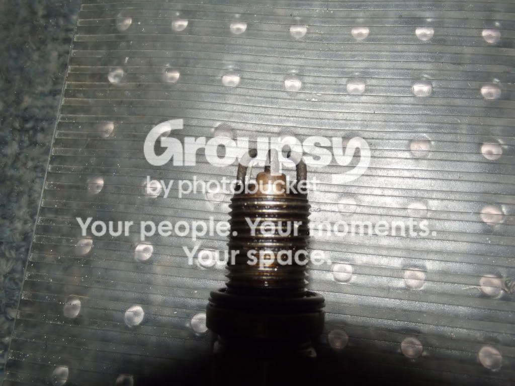

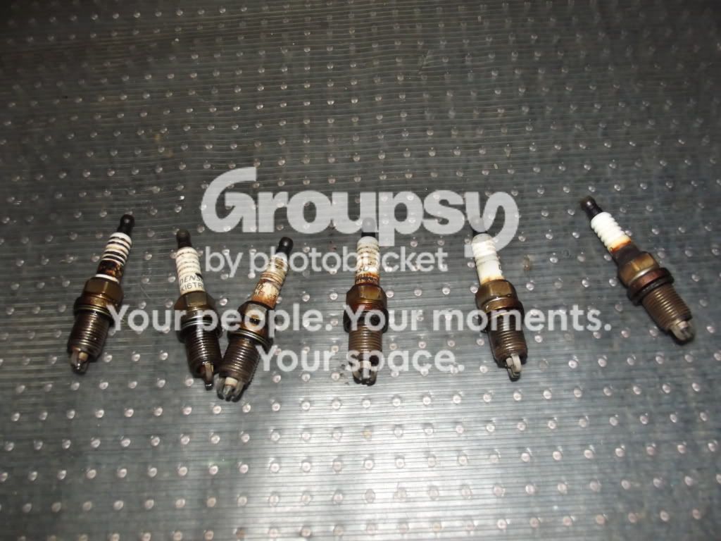

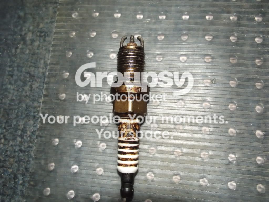

Well, my buddy came by, and his scanner gave me a Cylinder 1 misfire! So we took a look at the plugs....(which were all Denso), and found them to be in pretty poor condition!
What do you guys think??? HA HA!

New plugs for sure. I know everything in Canada is more expensive, but I'd some some pennies for some wires. Get some dielectric grease as well.
How is your PCV valve looking these days? Burn any oil? It looks as if you have a good bit of oil residue around the electrode of that one plug.
by the looks of the plugs you may have a light oil leak into the plug tubes, which could mean the valve cover and plug tube seals need to be replaced...

I'm not 100% sure, but the oil residue is most likely due to the valve cover leak I have. Both are seeping oil, but not a fast rate. Actually, it's barely noticeable from one oil change to the other.
The one thing to consider is, those plugs are 13 years old, so they are going to have some gunk on them.

The leaking valve cover tube seals then explain where the oil is coming from.
