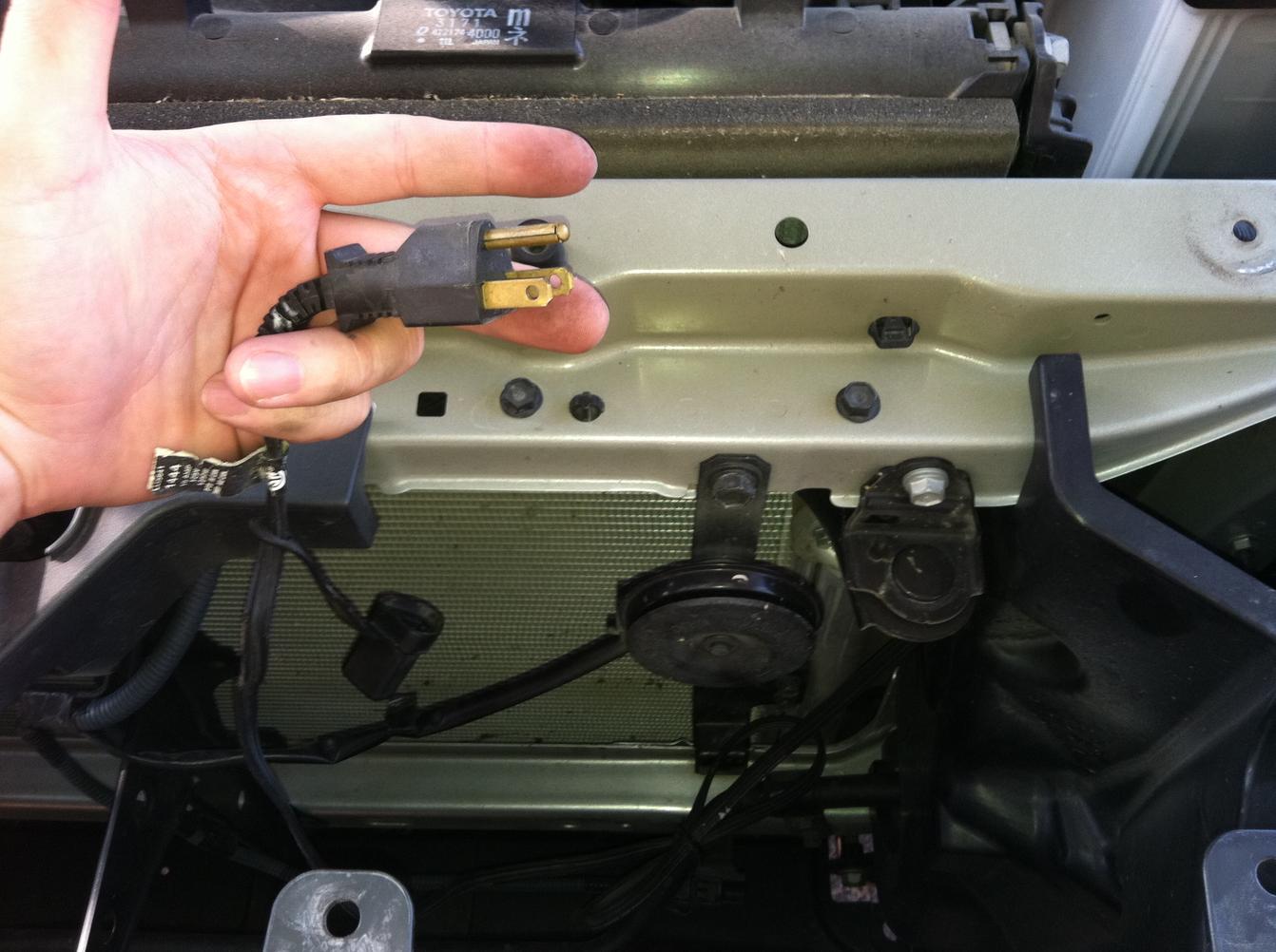

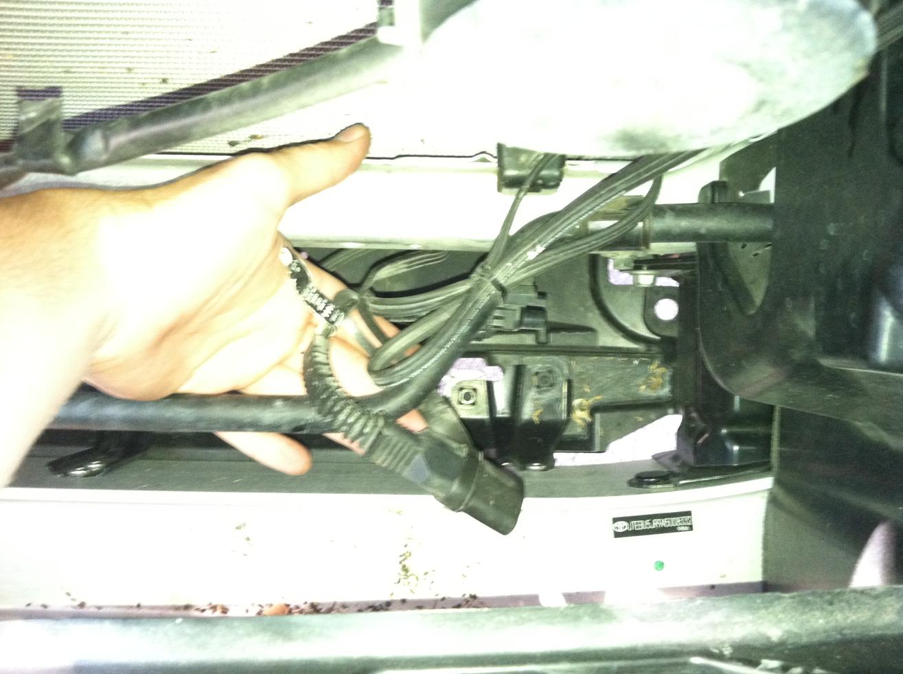

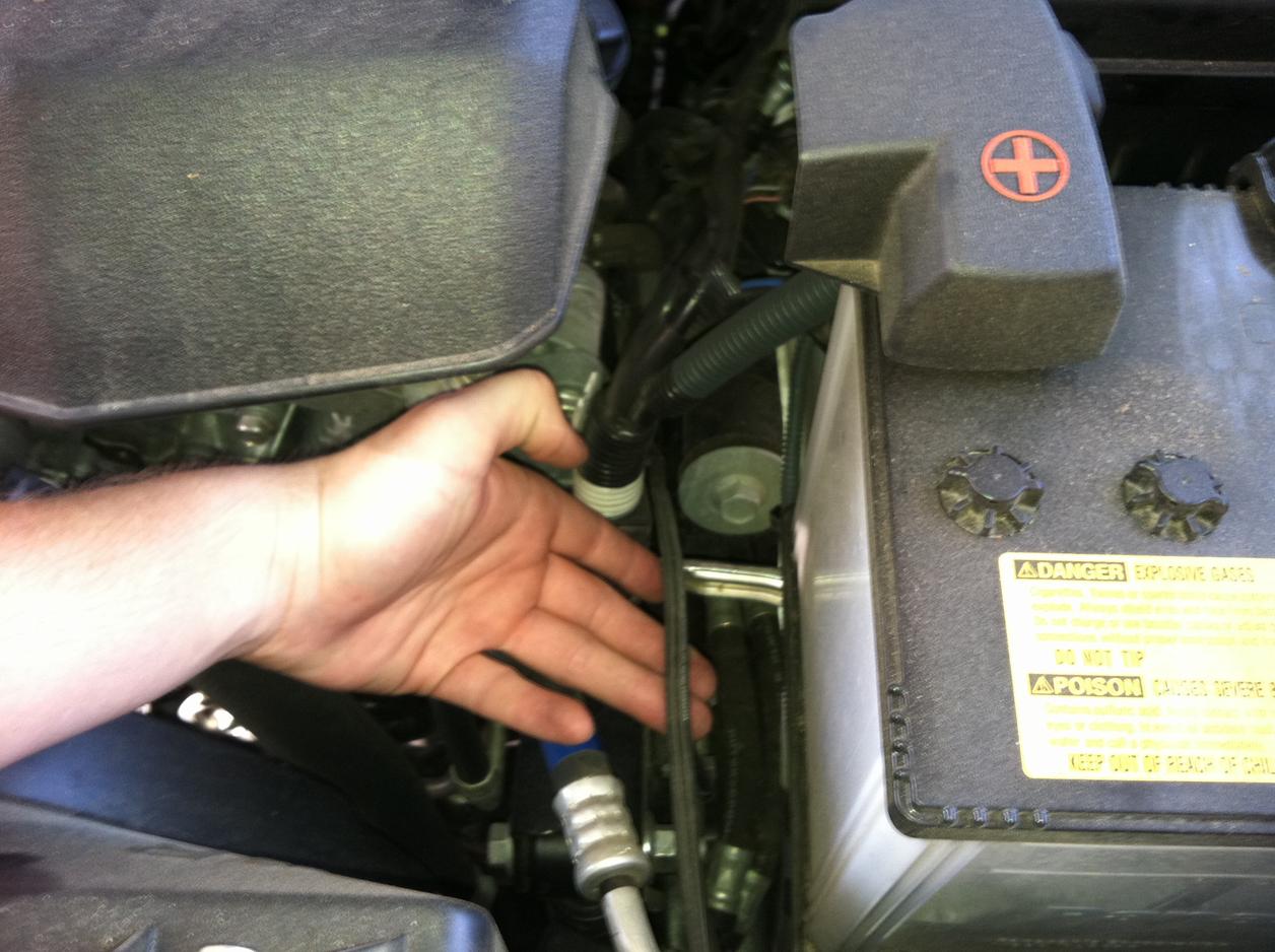

Today while tackling the new horn install I ran into something though that I had to share. All the while I have suspected that maybe this ride has had an aftermarket bumper on her before, which might explain the front end sag, the disconnected lights and my new discovery... see below. There is a 3 pronged plug zip tied to an A/C line in the front end. Why... I don't know? The wire is heat shielded and passes back through the engine compartment and down, and terminates into the alternator? Can someone identify what this is for? Is it stock? Is it for a winch?

Yea, its a block heater. When I lived in North Dakota that was a requirement. You wont be needing it in TX. Lol
I did the antenna...
Looks like the Block Heater is the answer. Thanks Ducmonsta!

Double check.....Are you sure that the plug wires up direct to the alternator.Not that clear in the pic.Doesn't make sense. The alternator is not putting out electricity unless the belt is turning it's pulley.
I've seen them where you take a freeze plug out and put the heater in the water jacket,which is down by the alternator, on the block and put one in there. Plug it into external AC to keep it warm.
I think some Canadian 4Runners had a block heater as an option.
Correct, block heater an option on all Canadian 4Rs. Plug and cord looks exactly the same, and insulation makes sense. Even though it looks like it goes to the alternator, my bet is it goes past it, then on to a round port on the side of the block.
While probably useless in Texas, block heaters really are a nice feature anywhere the temperature falls below zero (32F for you imperialists).
You can also test it: Put the truck in an extremely quiet area (like a garage with door shut), open the hood, and plug it in. You will hear a very slight noise, almost like an electric kettle warming up.
