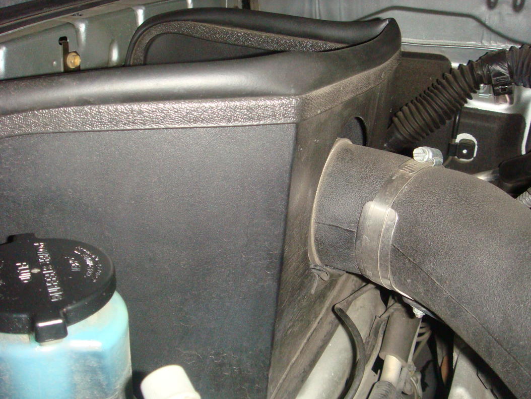

Ever get a rattling noise from the engine bay Tom? I couldn't figure it out for the longest time and finally found out it was from the intake tubing hitting the heat shield. I cut out a piece from the extra edge trim and lined the bottom of the hole of the heat shield. I also find that my filter comes loose after awhile and am always having to tighten the hose clamp.

Yeah I would get that at high throttle but I tightened the bolts and it went away. I also periodically re-tighten the clamps. If you have a picture of that modification I'd like to take a look at it. Lately I've had two odd issues. 1) When turning the engine on I get a weird noise coming from the passenger side dash area as the engine turns over. 2) When the brakes are cold and I release the brake pedal from "R" it sounds like my front passenger brake is breaking loose. It is quite audible and there is also a hissing when apply the brakes. It's weird though because it only happens when it's cold and if I hear the hissing all I have to do is release and then re-apply the brakes and it goes away.
