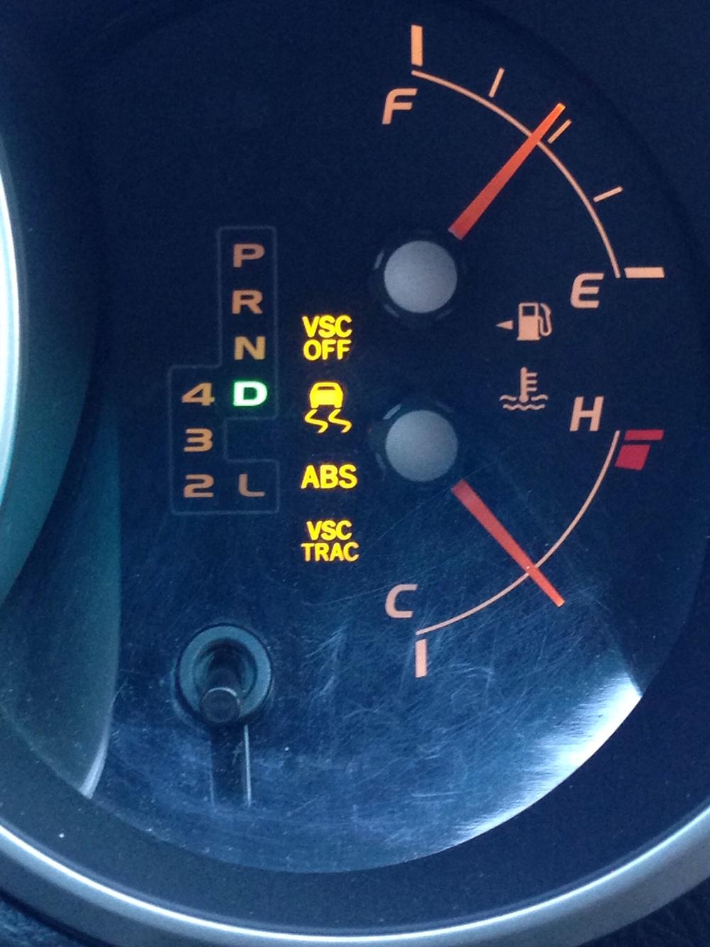

I have a 2006 toyota 4runner sr5 v8, 4wd with 74000 miles. In the past month my abs, vsc trac, and pic of car skidding lights all 4 will come on in the midst of my driving. (See pic below) It seems to happen most during or after I have been sitting in traffic. The lights will go off if I restart my car. They never come on initially so I don't think it's the battery and it usually takes 5-15 mins before they come on. It also doesn't do it consistently as there are days I can drive without issues. This week it has happened three times. None have occurred when raining.
I've taken the car to the toyota dealership twice and they don't have a clue. They say they can see which codes are malfunctioning but there could be 5-6 different things wrong under those codes and nothing seems to be wrong with any of those items.
What do I do? I'm sick of these lights coming on bc to me it means something is wrong with my car and I'd prefer to have this fixed while I still have my extended warranty plan. Any thoughts????

So the pic of the lights was taken while driving. No other abnormal lights on. No check engine light on.
Once the 4 lights come on, they stay on until I turn the engine off and are gone upon turning back on. They came on again this morning on my way to work. Clear day, no rain, temp 42 degrees. I had been in a little stop and go traffic for 5 mins, then interstate for 7 mins, got off interstate and on side streets driving about 30-40 mph for 3 mins. Was slowing down to make a left turn and lights came on. Parked car, turned engine off, foot off brake, turned car back on, lights gone. No warning lights on my commute home. There's no pattern.
