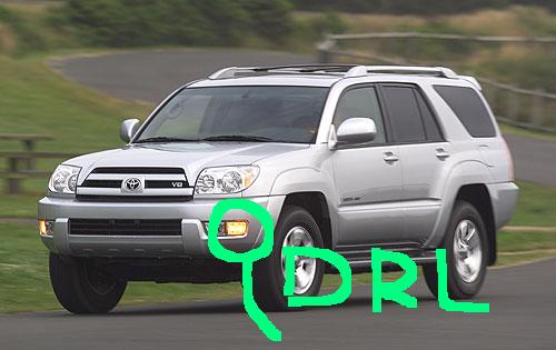

I HAVE READ SO MANY FORUMS AND POSTS SAYING ALL DIFFERENT TYPES OF BULBS FOR THE DRL....WHAT BULB SIZE IS IT!!!!! :bash: :bash:

It might pay to take a look at the bulb. Sylvania lists the 4157NALL bulb for the 06 as well but it's wrong. I just replaced one last week and it takes a 1156NA.
It's what I would call the old fashioned type because it's a push and twist bulb.

i just took some time and went under my truck....i took the bulb out and it turns out that sylvania is right and the light is 157 is says it right on the bottom of the bulb. i think i might look for some hyper white or xenon white bulbs for these, tired of seeing everyone with yellow.. thanks for the help guys

In that picture by donnie, the lights he circled are the turn signal lights. The DRL are the corner bulbs in both headlight assemblies.
