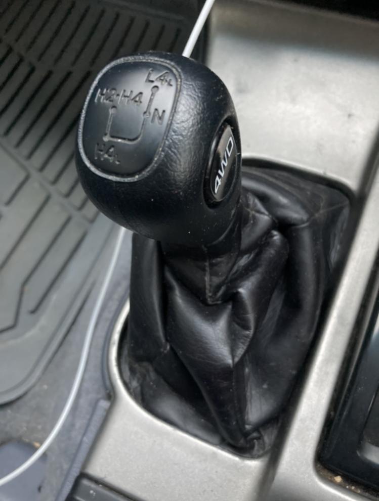

This is my first 4x4 and I really would appreciate knowing how to use the 4x4 system. I have the transfer box lever shown, I understand you push the button on the side to change between h2 and h4, N is obviously neutral. But what is the little L for, does it lock the rear diff? I have no switch around the steering wheel for and other locker.
Also what types of terrain would I use each selection on, I’m thinking, muddy flat field, hilly farmland, beach, riversides etc?
Sorry for the novice questions

With the mutimode transfercase you have the following drive modes:
2WD H2
Normal driving on dry paved roads
AWD H4 center diff unlocked (Activated with the 4wd button)
Driving on slippery paved roads (road with intermittent snow\wet\ice)
4WD H4L center diff locked
Driving on gravel, sand, snow, muddy non paved roads
4WD L4L (low range with center diff locked)
Driving on gravel, sand, snow, muddy non paved roads that generally are steep and require very low speeds (under 10MPH/15KPH). Will help when going down steep declines as well.
