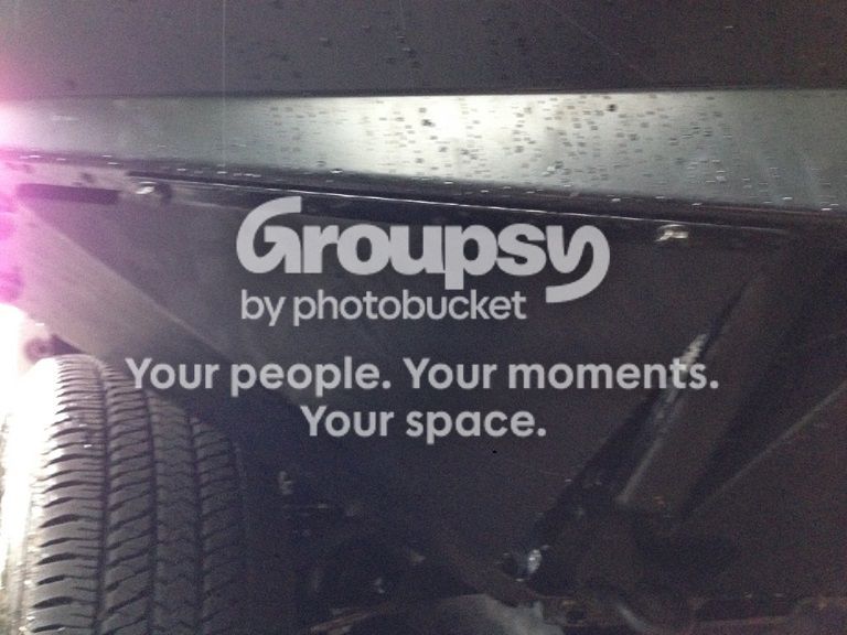

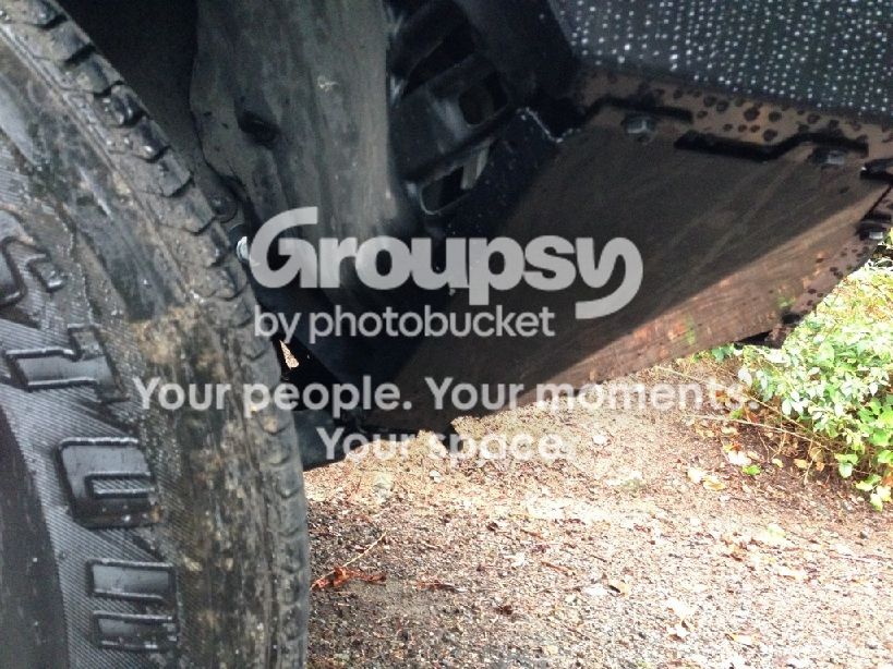

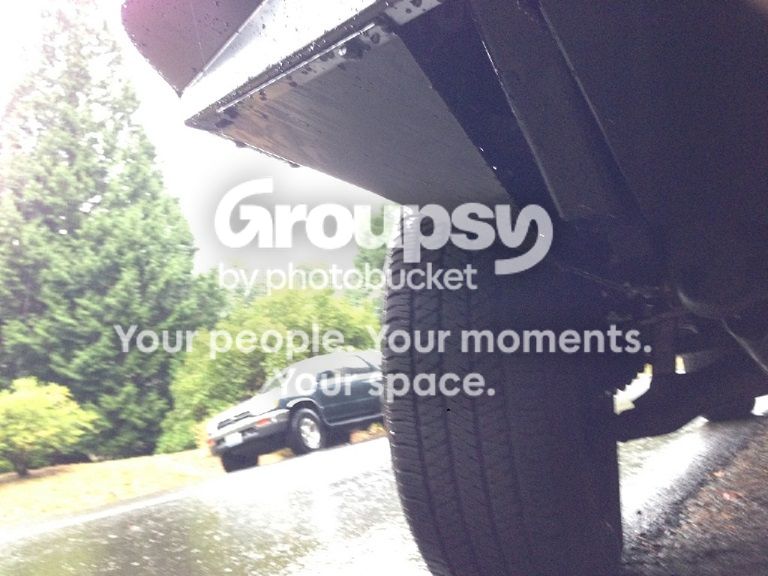

Sorry for the late reply, I'm out of town for a couple weeks. I got my brother to take a few photos today though for this, you can spot his 3rd gen in the background of the 2nd pic.
1st pic: taken head on from underneath. looking at the front of the passenger tire side.
2nd pic: taken just to the right of the first pic. basically taken from the center of the front bumper looking to the passenger front side of bumper.
3rd pic: taken from passenger side. front is to the right.
IMG_20150815_012913_01.jpg~original
IMG_20150815_012913_03_1.jpg~original
IMG_20150815_012913_02.jpg~original
I hope these help!
PS - looking closer at your pictures: basically, if you were to stand directly in front of your 4runner, take the piece exactly as shown in the last pic you posted, rotate it 90 degrees counter clockwise, and lift it straight up onto the front driver side of the bumper, there should be holes for it to go into. They aren't tapped, so you'll need bolts/screws and nuts. The single oval slot on the stone guard (what ARB calls this piece i think) by itself actually bolts to the frame IIRC.
