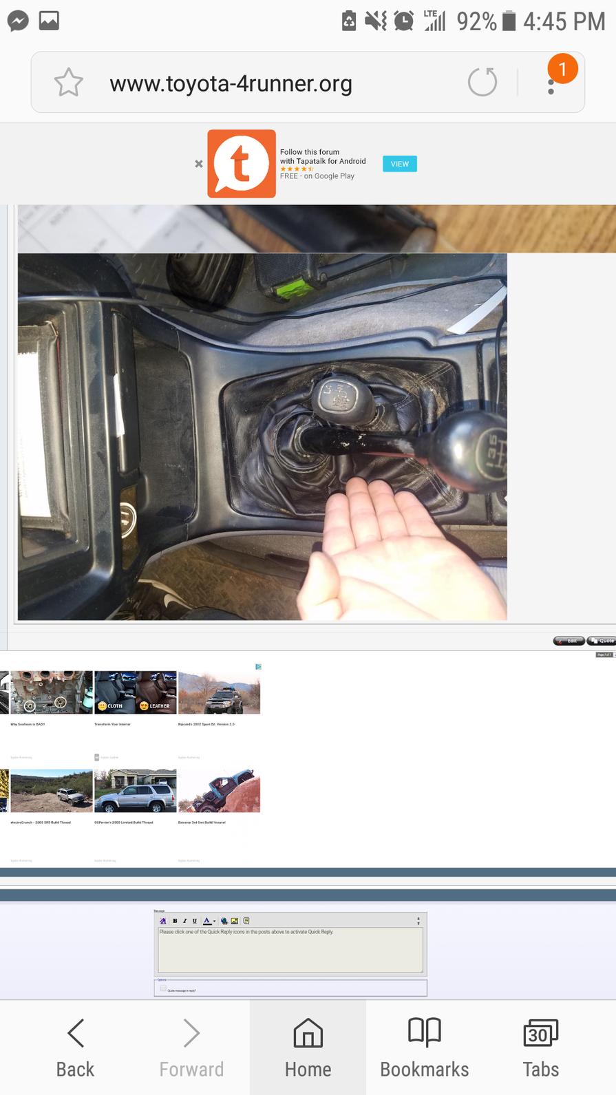

The gear shift just pops out with what looks like a small dome under the rubber boot. remove the boot, spray with some lube, let it soal,
press down lightly on the dome and it should rotate about a quarter turn to the left and release the shifter.
sort of like the pic

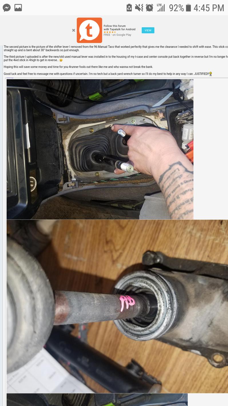

http://www.toyota-4runner.org/3rd-g...t 96 taco Manuel lever was a dam perfect fit!
glad you found an easy deal and glad to help out you a little

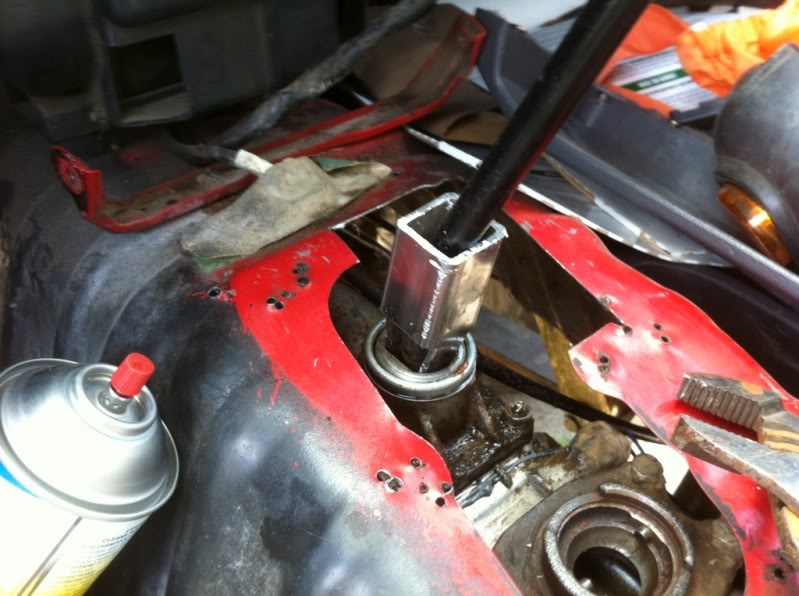

when you mentioned a sleeve i remembered I made this a few years ago.
remove the shift knob, slip it over, push down slightly and twist
