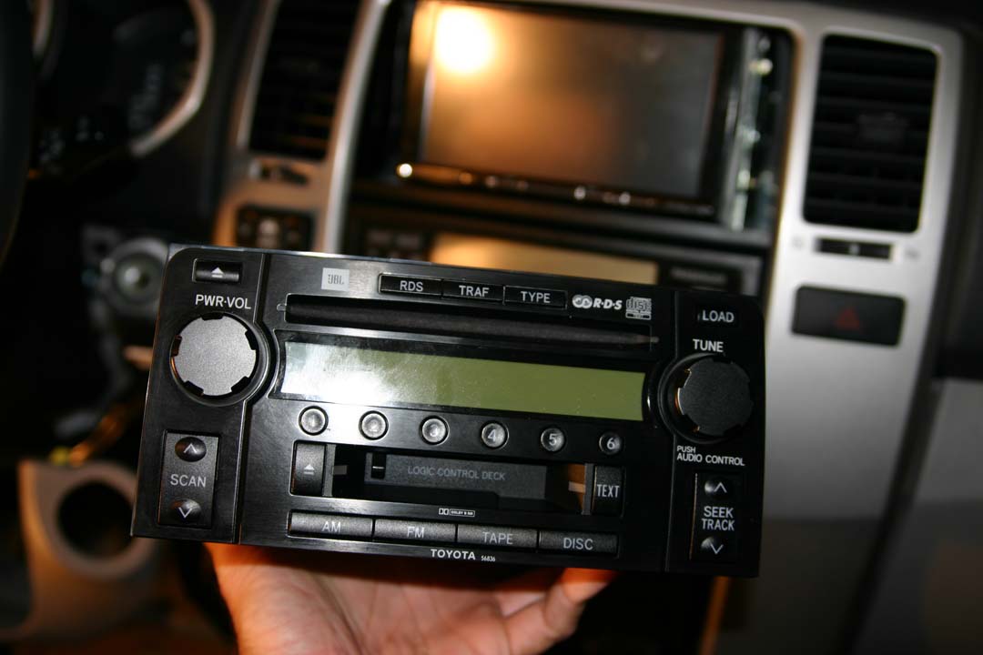

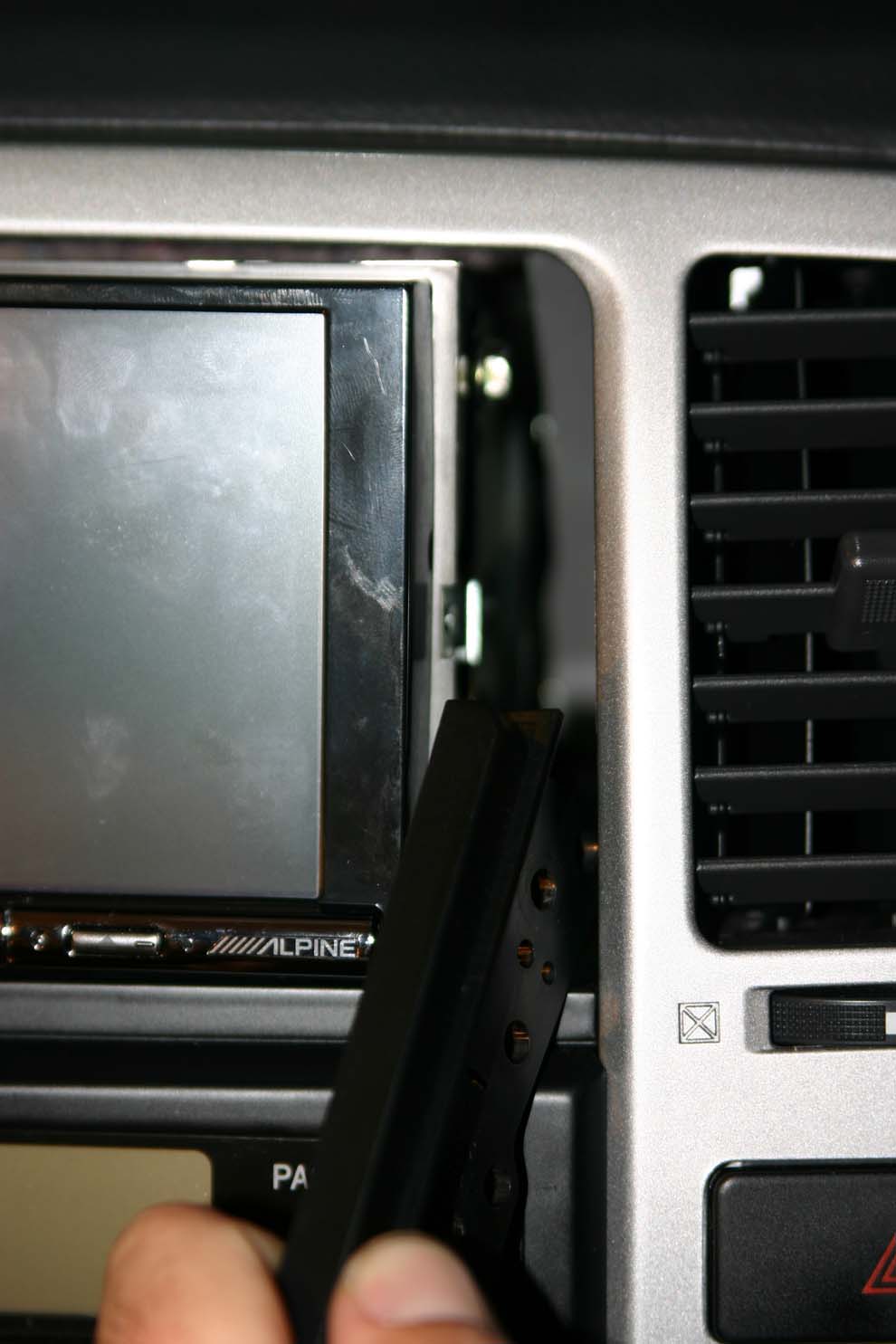

What is the best way is to cover between the new HU and the large gaps on either side?
The 10spkr JBL system HU creates a challenge and the Scosch adaptor is not wide enough. I can not find online any other adaptor that will work.
Does an example of a custom instal exist for the Alpine W200?
Any advice or pic's of the same kind of instal would be helpful.
I want to do this as cleanly as possible and I have not been able to find a kit that will cover this problem.

From what I recall reading here, the JBL radio and factory nav is wider than the regular radio. In order to close up that gap is to get the AC bezel from a truck that has a regular radio.
I was wondering about doing something like that. Is it that simple?
The bezel is a direct swap from say an 03 SR5 to the 05 Limited but with the different radio port?

Found it. In this thread they mention that there's a difference in the passenger airbag or seatbelt warning lights.
Also, found this one for sale.
Onebeachbum05 said:
Thanks much for the help. I had no idea what to call it besides radio cover.
Time to see if someone wants to swap.
You're welcome. I searched using the term "radio bezel". Good luck with the swap.
