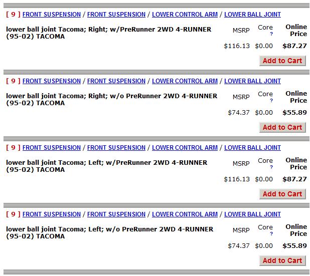

Im looking at sites that i have bought things from before and on this site it has the option of "w/pre runner" and "w/o pre runner".
Im guessing i want the w/ pre runner right?

I meant cheap as in Original Toyota Genuine Part cheap. Because there are differences in prices on various genuine dealer sites.
Tacomas had different specs between 4wd and 2wd models, unlike the 4runner
The 2wd had even wimpier front ends, if you can believe that
So, if you got the Prerunner package from Toyota it was a 2wd with the front suspension, among other things, of a 4wd.
So you could just order Balljoints from a Taco with 4wd, or get it WITH the Preruner package
The Prerunner model, wether a 2WD or 4WD is a 6 lug, and non Prerunner is a 5 lug (from 98-04). 95.5-97 had no Prerunner package, so 4WD was 6 lug and 2WD is 5 lug. I'm not sure why their website says 95-02. That's odd.

Thanks! just looked up their price and its better plus like you said i can save on shipping. My nearest dealer is Hooman toyota and the prices there are really high even for a dealership.
