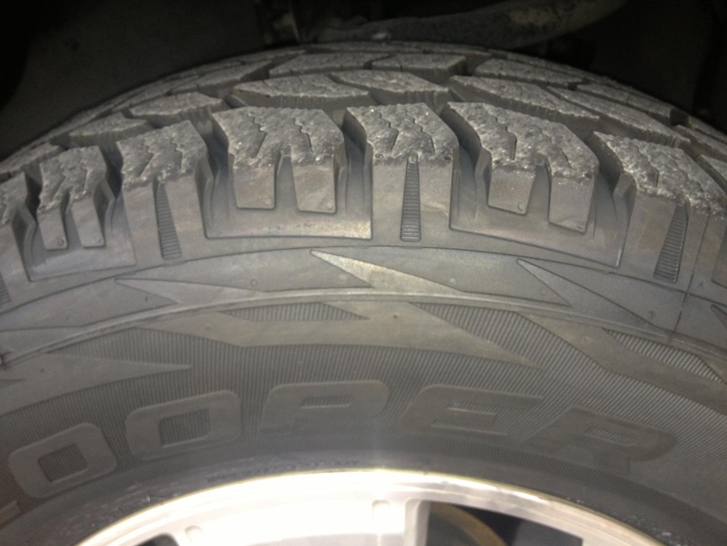

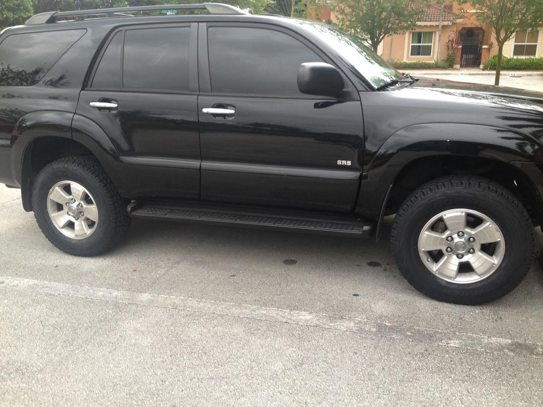

New Cooper AT3 tires installed today
Well I'm very happy with my decision so far. I went with the 265/70/17 Cooper AT3's 560AB. They look 10 times better than my old dunlop AT20's. Other posters were right on in regards to the aggressive appearance of these tires. They look much better in person. I noticed these tires raised the height a good 2 or more inches switching from my bald tires. I drove up to 70mph on the highway and they were very smooth. Couldn't hear much of a difference between my old tires and these. They have a softer ride and the steering wheel moves more freely than before. So far I would highly recommend them for street and rain use based on my short test. I chose to install them with the black wall out but if you flip them, the other side has the white outlined letters. This may help anyone looking since I was not sure if they had the outlines on both sides of the tire.
