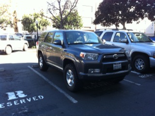

On my 2008 Tacoma I had the wheels you're looking at, came stock on the Sport Editions. I later bought and installed FJ Cruiser Aluminum Wheels which has the same backspacing as the Trail edition wheels on the 4Runners which in turn gave me a slightly wider stance.
Just for reference, Basically I ran the Trail wheels with Spacers on my 4Runner which is the same as running those FJ wheels with spacers. If I were to put those Tacoma wheels on, they would be tucked in about .75" per side.
Its hard to tell in the pics from the angle, but the stock wheels were tucked inside the fenders about .75" per side, with the FJ wheels, they were then flush with the outside of the fenders.

The 5-spokes fit...
I'll try and get better pictures up soon.
