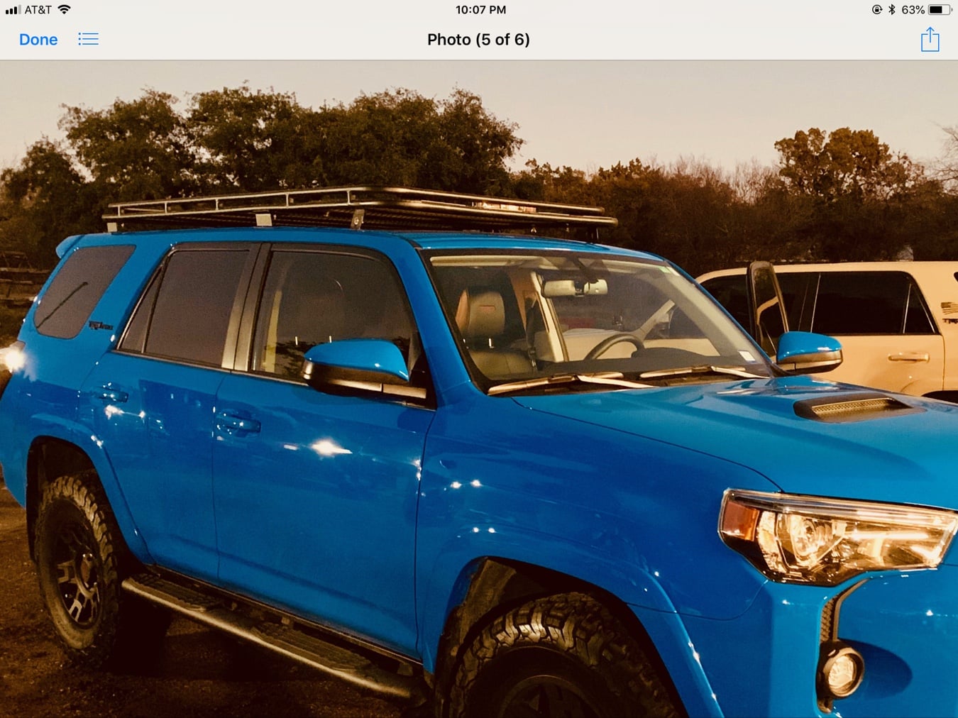

Why would you take a screenshot of the image, instead of just uploading it directly? ;)
I'm still torn on this color. I can't wait to see it in person.
Got the image from the owner. He lightened it somehow and that is how he sent it.
I didnt think i wouldn’t like the color but it looks good in person.
