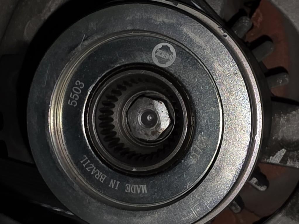

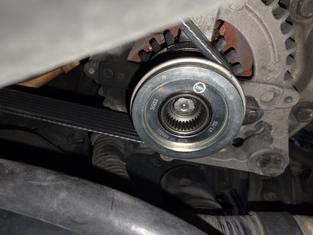

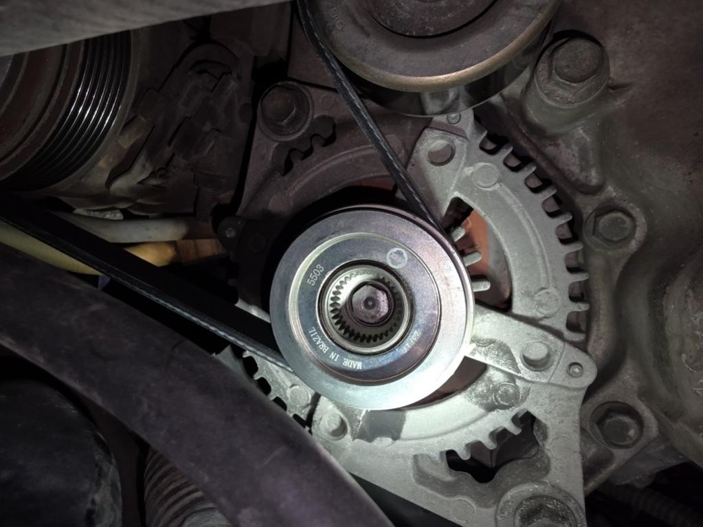

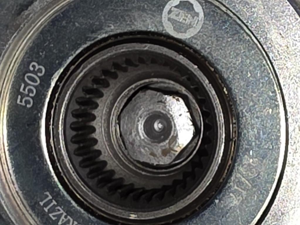

When I pulled the plastic protective cap from the pulley I discovered a different brand pully on the alternator (Zen 5503) which requires a different tool . Luckily the tool kit I purchased seems to have the right equipment to do both. I did check and it appears both pulleys are interchangeable.
The splines from the holding nut-tool clamp in perfectly, however it seems as there isn't ANYTHING on the inside of the pully on the alternator shaft, for the other part of the tool to grab onto. I am not even able to see any splines for either a torx or hex tool to fit into the alternator shaft. Is anyone familiar with this zen brand and the removal of this pulley? I've even found a video from the Zen manufacturer site, and it appears as if I have the correct setup for removal, but nothing on the internals to grab onto.
https://www.youtube.com/watch?v=kxTb23ZlUmA
Attached are pictures of the pully on the alternator for reference. Perhaps someone with better eyes sees something I do not.
