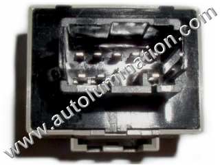

I've got the LED's and the recommended flasher relay but the harness does not match the new relay. The stock one is much wider. I've looked everywhere and it seems this is the relay everyone is using. In face the numbers on the new LED relay match numbers on the stock relay. (81980)
Here's what I bought, it's the same as what they have at V-LED's and many other places:
And here's what I have for the stock harness:

Any thoughts? I've searched all over the web and have spent a long time looking through the online parts databases. Not sure what to do - I really don't want to use resistors.

if u took out the fuse box more there is another harness that plugs in that, that pic im seeing is just an extension, u gota trace it more back and u should see the smaller plug, that one will fit the flasher. and u will loose the daytime running lights
Thanks, I'll look further. I'm almost done with the VSC module. Just ran into one minor problem and am waiting for Kliv to help point me in the right direction.
No Go. I traced it way way back - nothing. Searched for just the harness and came across a relay. I don't have this but this is what I need to use a different relay...
Part number: 82241-04030 wire relay
ugh, more waiting and I get to take it all out again. weeee!
