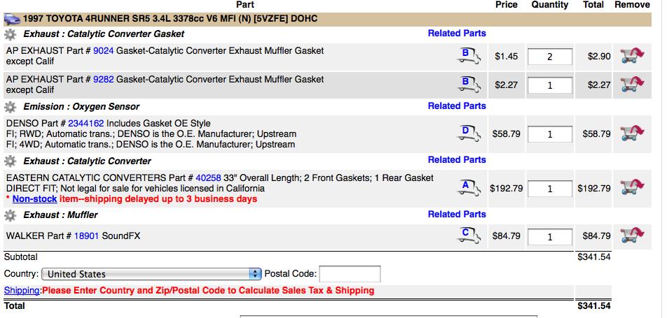

After alot more research, I managed to put together a list of items for under $400.
If you know the parts I need, or if you could take a quick look to see if I missed anything, it would really help.
Just a reminder.
1997 4Runner SR5 V6 Engine
Cat Stolen, cut pipes, so seems easier for me to replace with a full direct fit Cat and Muffler replacement to avoid welding.
I have attached a screenshot of the list of items. Just not sure how it will work with a Walker Muffler and Eastern Cat, hopefully everything bolts onto each other since it is direct oem fit? Also ordered gaskets as needed.
Now that I think about it, sounds like these parts do not come with nuts/bolts and those are gone so might have to order as well.
Also, From the images I see of the Cat's, I only notice 1 place where the O2 sensor could go. Is the other sensor on the Muffler pipe aka After the Cat? I have not had a chance to get to the car (parked in a garage) but will double check about the sensor from under the hood as mentioned.
Thanks again for all your help! I hope to get this sorted asap so I can let Geico know to drop the claim.
FYI, parts are from http://www.rockauto.com

Singtoe, thanks but already got all the parts.
It took me a long time, especially to get damn 14 year old rusted nuts off out of a tight spot. Used Impact Wrench and Liquid Wrench and finally had to go buy Damaged Bolt Removers from Crafstman. Came out! Removing the old parts also required sawing off pipe due to badly, i mean badly rusted bolts that were no longer bolts.
Installed an Eastern Catalytic Converter, Walker Muffler, and Bosal Tail Pipe today, went to dealer to pickup some bolts/nuts to replaced stripped ones.
Sensors were never taken fyi, so bought new gaskets and reused them.
Started the car up, sounds purrry again, not like a Harley. No Check Engine light so far, smells like burning though, probably cause of the new stuff?
I turned it on, let it run for a few minutes, and off again. Did that a few times. Noticed that on one of those times, it would not start so easily unless I gave it a bit of gas (never had to do that before). then it went back to normal after doing the same thing a few more times.
Did not ride it yet, want to see how it starts up in the morning.
Wish me luck! I plan on taking to Meineke tomorrow AM just to have a look over.
This was a great learning experiencing in wrenching, however, if I had the money, I'd have it done professionally. Just no $$$ for that these days. Hope I do not regret it. All in all, Muffler/Tail Pipe/Cat and misc gaskets/bolts/nuts came out to just about $400. Geico quoted me $700 to fix. Maybe I should have gone OEM for the extra $300, but like I said, great learning experience. Frustrating, but learned alot and should help in the long run.
