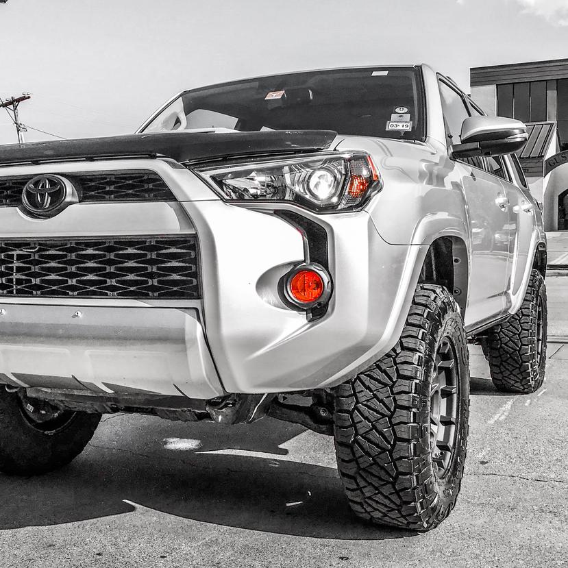

You can see below what I am currently running. My next move will be the adjustable 5100s on front, remove 2.5 spacers and either reuse stock coils or perhaps go with afternarket set like Toytecs, unless anyone has alternative advice. Current ride comfort is not bad, but I am thinking the 5100s up front will maybe even be better. Im not a hardcore offroader - just occasional weekends at the ranch. You’ll find this to be a great forum with good folks and advice. Enjoy your project.
My 2016 TEP
Quick shot of my current set up...

Howdy Dru-
Thanks for sharing! So you did just spacers in front and blistens in rear? Was this because of budget reasons? I might be ok with 5100 for both and install with new budget of $800 (fingers crossed). I'm definitely not hard core off road -not even weekend warrior. Monthly warrior? I want a higher look without compromising ride comfort (or at least very minimal compromise) but definitely want to have the option of off roading once in a while. I think I might wait until next summer and try some trails with my stock feet to see what I really want and willing to spend. Yeah this forum I great- many helpful members. I need to do a meetup and meet some people in my area!
