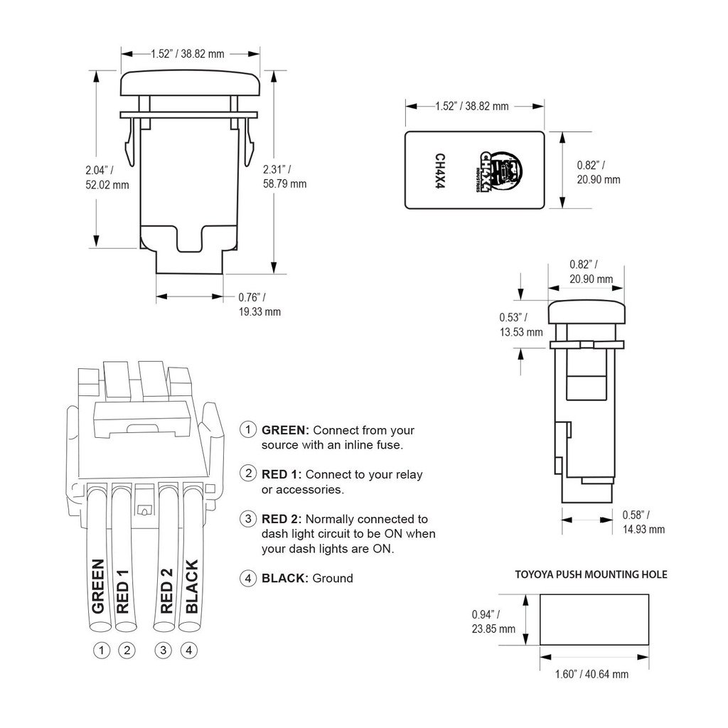

So this is the schematic

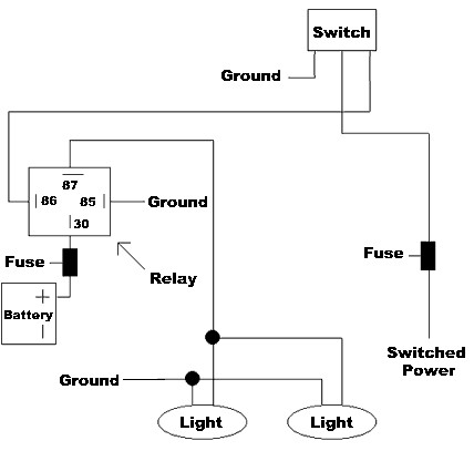

I have a wired relay harness that has only one trigger wire to go to a switch...
Could anyone explain to me what I am supposed to do to with the green wire?
Do Red1 and Green just get tied to the one wire from the relay?
Green is +12V source from the vehicle (constantly on from the battery or only on when key is in 'Run', your choice)
Red 1 is the on/off output from the switch, wire this to the coil of your relay (automotive relay pin 85) and wire the other end of the coil (pin 86) to ground. Now the switch will turn the relay on/off.
Red 2 is the switch's LED illumination, wire it to the dashboard illumination signal (don't know what specific wire that is)
Black is switch ground, wire it to ground.
Now for your relay: Wire a fused +12V to the relay input (30). Wire your light's positive feed to the relay output (87). Ground your light's negative feed.
That should do it!
