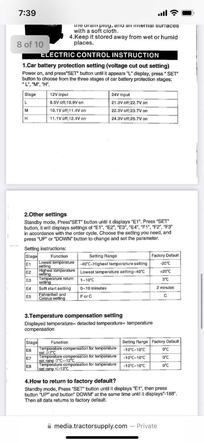

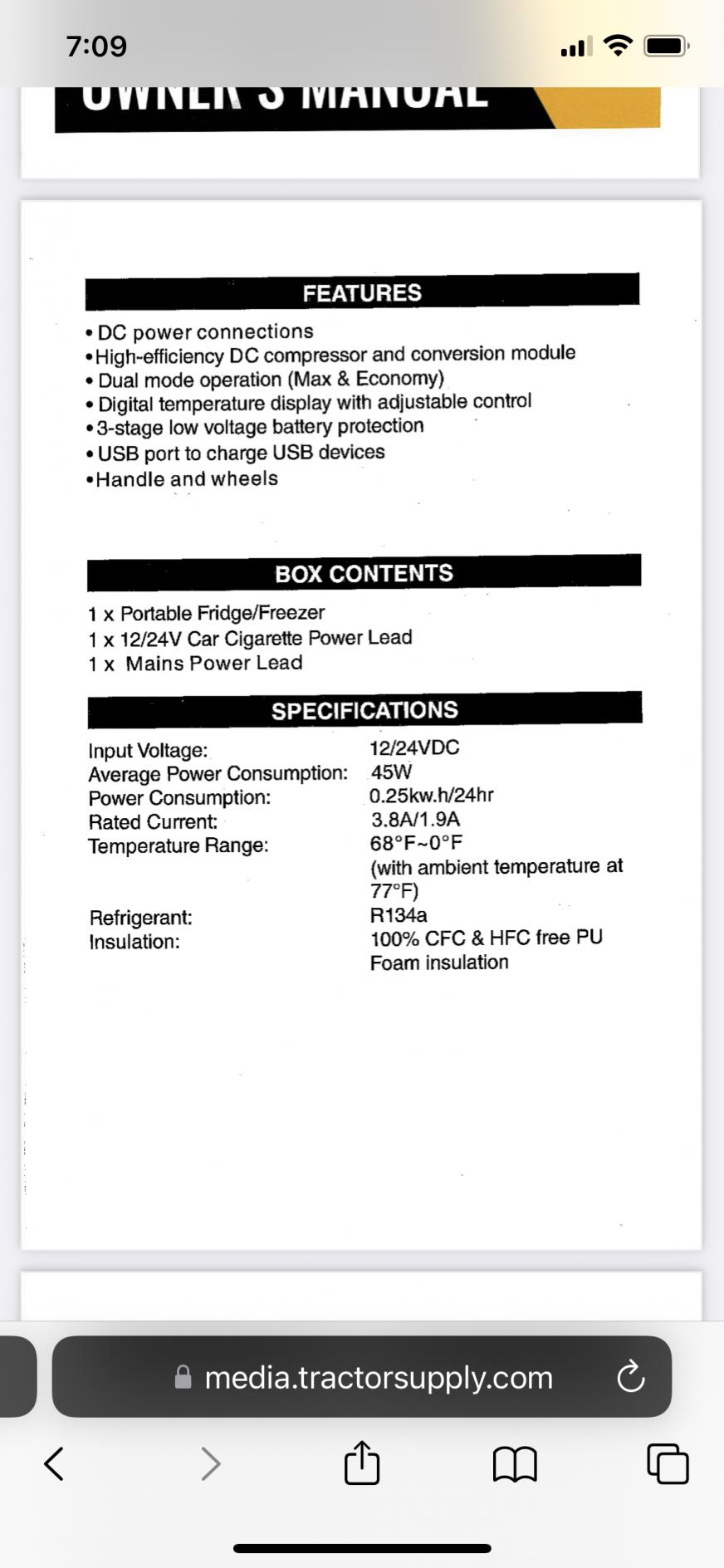

Im moving across the country and have to keep breastmilk frozen for our kiddo during the 6 day drive. Would this fridge be ok plugged into the hatch power plug? I would bring it in and plug it into the hotel power socket every night to keep it frozen and not kill my 4runner agm battery.
Our original plan was 2 huge coolers with dry ice (impossible to find apparently, everywhere around us hasn't received a shipment in weeks).
This fridge/freezer looks like a better option if it will run off the hatch plug.

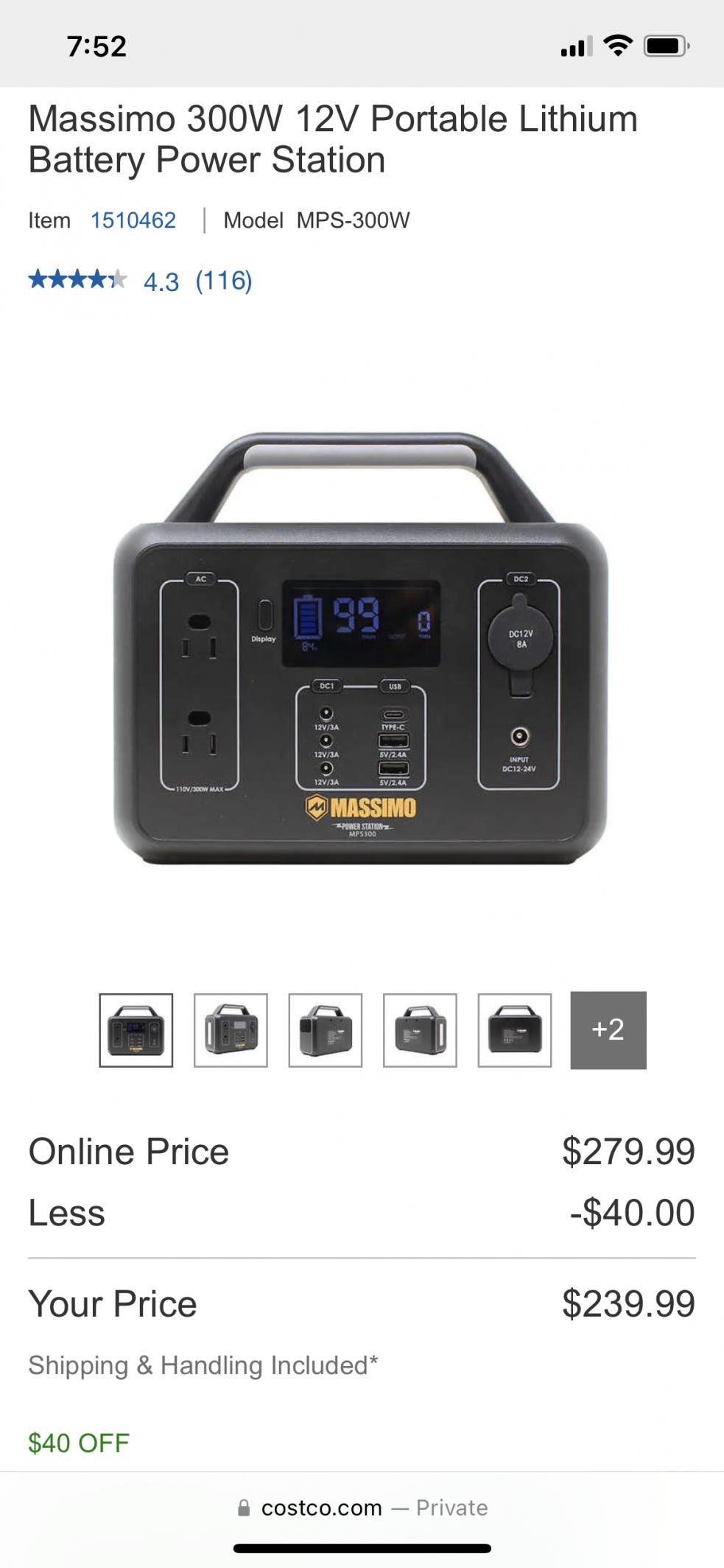

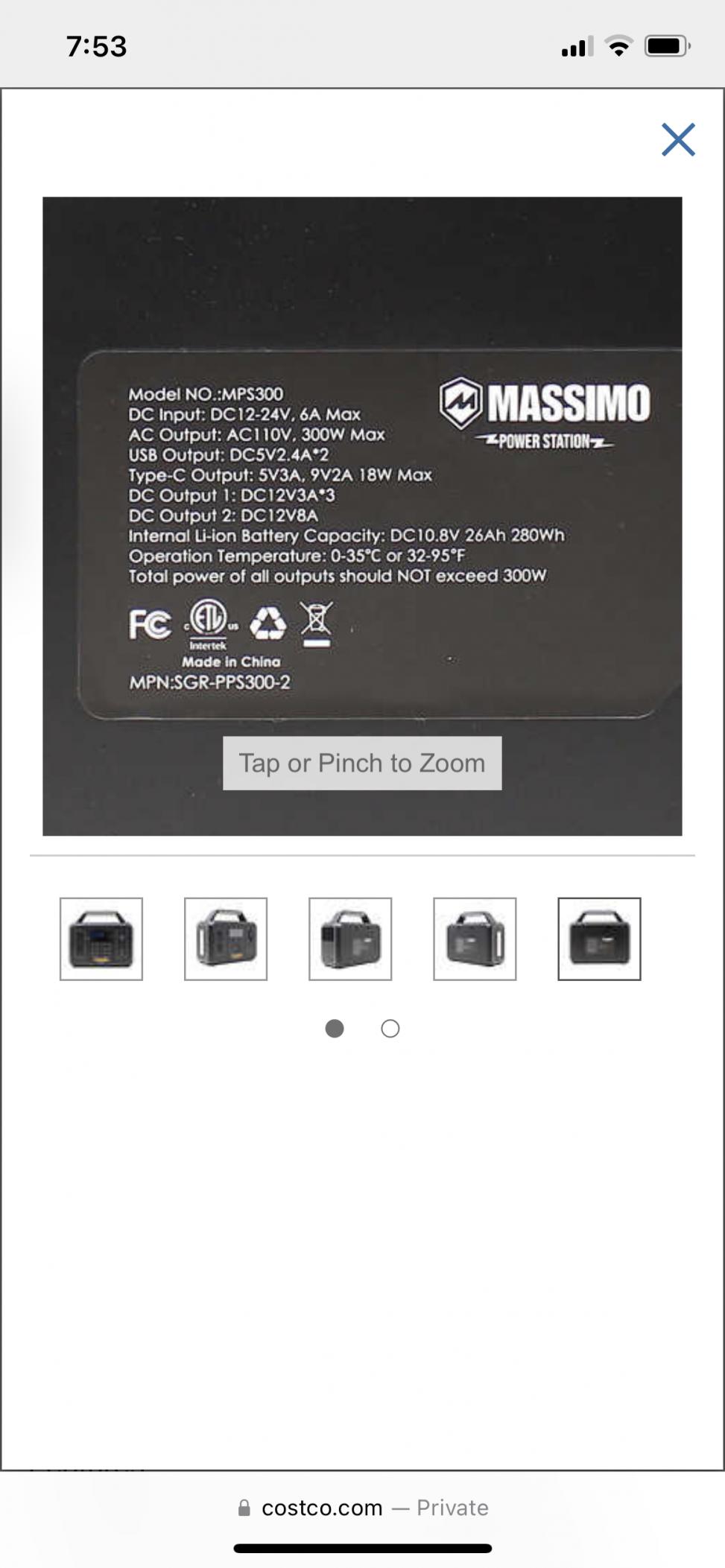

Maybe this is a better idea? Get 2x of these to power 2 fridges for the 7-8 drive (per day) then plug them all into the hotel rooms when we check in?

For safety/security's sake I can see lugging everything into the hotel room, but honestly if you've got the freezers down to 0 before you start, have the batteries fully charged, and are driving 6-7 hours with them plugged into the truck so that the freezers are being powered while you drive and it's keeping the batteries topped off I would think you will have no worries for the battery packs keeping the freezers running over night. I just got back from a 2 week road trip with a setpower a40 fridge running off the rear outlet using a bluetti 700 battery and had no issues whatsoever. Since you have 2 units you may also be using the front cig lighter so I don't know if that stays hot when the truck is off, the back doesn't so it would automatically shift to the bluetti and there was never any chance of draining the starting battery

When I get to my spot, I plug into a Bluetti EB55. At 28 degrees, I get 10-14 hours. 0 degrees is going to work your power unit much faster.
