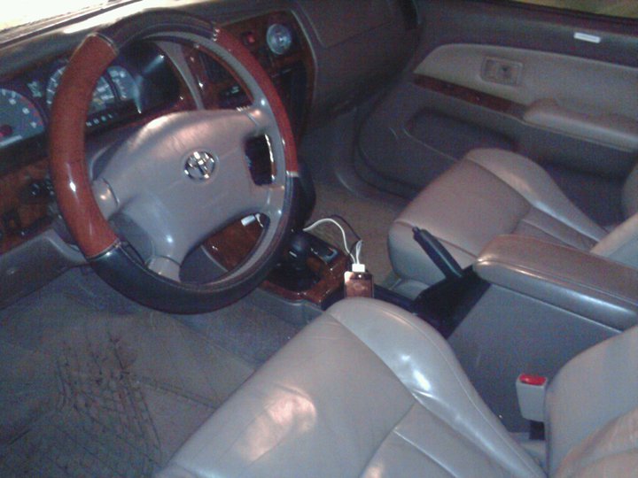

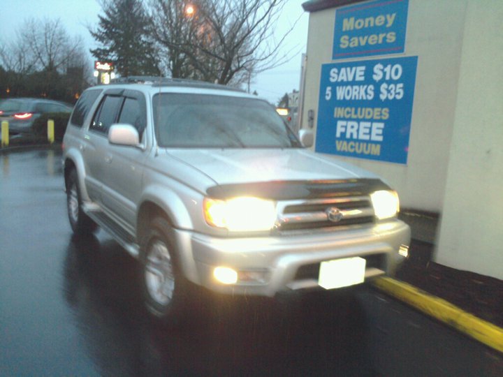

Just wanted to say hi! My name is Rich. I just purchased a 2000 Toyota 4Runner Limited yesterday. It has 95,000 miles and I paid $5,500 Cash for it. It was dealer maintained since new! I've been looking to get into one for the past year and hadn't seen any great deals. The only problem is the back window will not roll down with the console switch. Maybe disconnected?
I love to mod cars and have already blacked out the grill and smoked the tails. Deckplate mod is also done! This site has a great wealth of information! Thank you.
Here are a few pictures from before the mods.

:welcome: Sweet ride!! A 2000 with only 95k and for 5,500?! Thats a freakin awesome deal!! :bigok:
