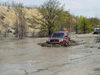

I've been through some very deep water on trails. Also, my wife uses the vehicle to go to work and where her job is located there is no drainage. When there is a bad rain storm - flash flooding (Couple times a year) she can only get through with the truck. She even uses the air suspension on high.

Yeah, wading depth is the main reason I don't have a CAI. I just need a snorkel, then I can have CAI.
I'm confused, the CAI moves the air intake HIGHER than stock, not lower?
I guess water could/would splash up there more w/o a sealed box, but you can actually go through deeper water w/a CAI, just maybe not as fast!
When you wade through deep water you want to maintain enough speed to create a bow wave, which puts the wheel well in a pocket of air.
