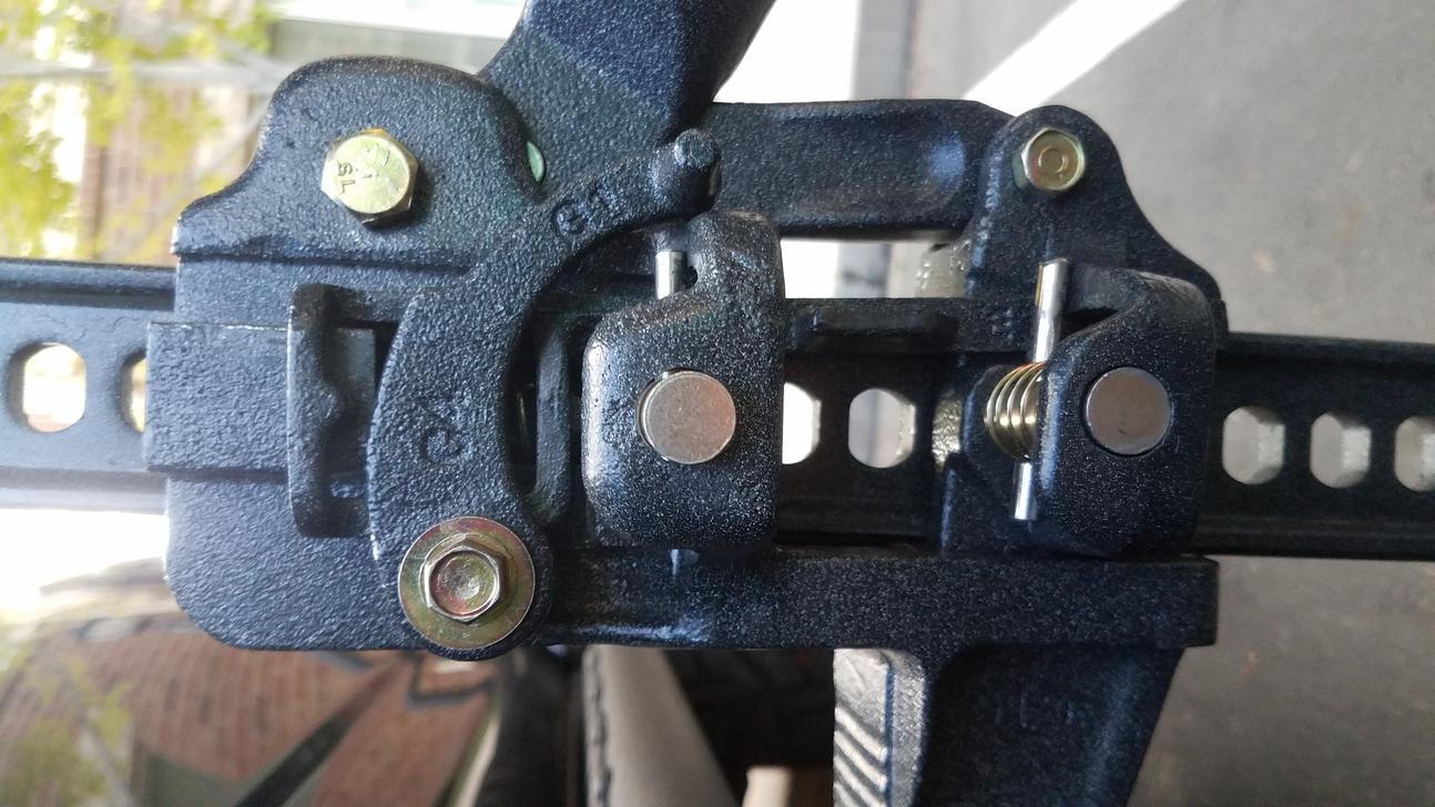

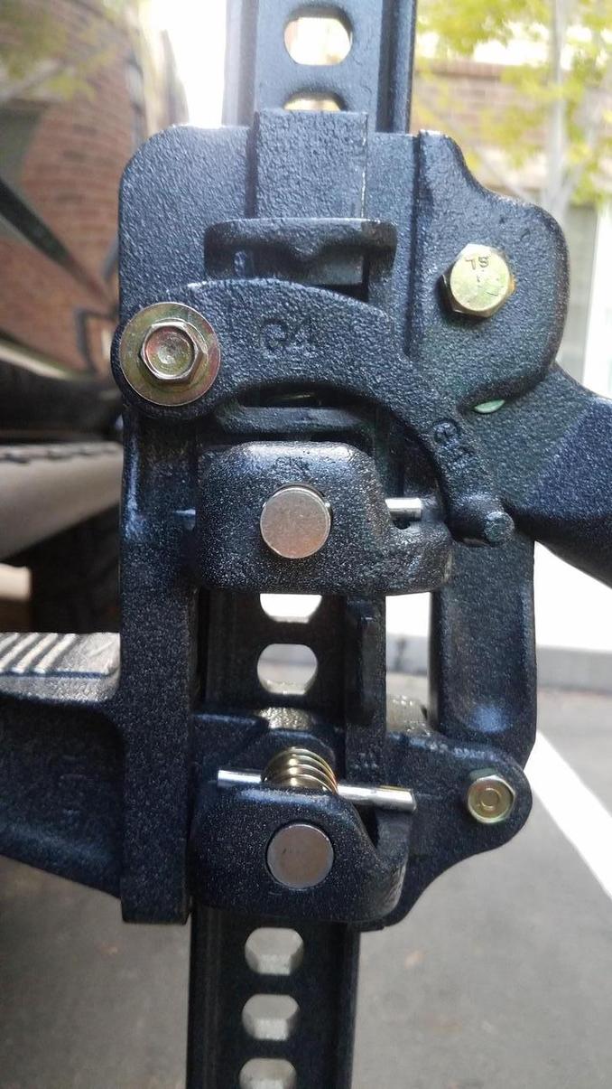

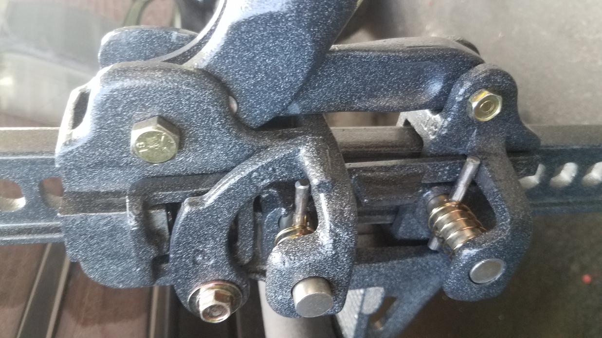

I have a high lift extreme jack and it will not ratchet up with or without load. I have tried pulling handle and attached piece up until it touches my skids and cranked down- it will lift about an inch nut will not lock pins on the next highest rung/hole. When I push lever parallel with main stem, it slides all the way to the bottom. I have included a couple pics. I am wondering if either of the pins that are pictured slipped on the wrong side of the guard and will not allow enough up travel to relock. Any help is appreciated. I am thinking about taking it to a high lift authorized dealer around SLC if nobody can figure it out. Thanks!

Your jack looks new/unused. Try spraying it with silicone spray or other spray lubricant that won't attract dirt, then work all the moving parts several times.
When you move that directional lever the pin should pop into one of the holes in the upright on the jack. Then depending the lever position, the lift plate should move in the direction the lever is pointing when you operate the jack handle. Lever pointing straight out is like "neutral" and lift plat can be moved by hand.

The little lever need to be in the up position
Your jack appears cleaner than how they come from the factory. Spray it down with some CLP, triflow, WD40, hell, water, and it should start working.

Has this jack been powder coated?? I've seen a few guys that had theirs done locally and the shop got a lot of finish inside the areas where the pins slide. That will really gum up the works unless you dismantle it and clean the coating out. It will eventually wear out with use but that takes quite a while and the flaking finish makes it raise/lower erratically.

I borrowed and rotated one of your pictures. Look at the little bracket just above your lever. You see the little button hanging down in the center? That is what the notch of your lever will snap under to lock it in the up position. You just need to move the lever with authority. You can't hurt anything on this with your hands. I've had to use a piece of 2x4 to knock it back to the down position. Lube on the pins and rotating parts is king with these.

In the pictures you posted the handle looks like it is down. Just a suggestion because I am not 100% sure, but put the handle in the up and locked position and see if the lever will stay up. It's been awhile for me but it seems like I ran into this the first time I dug mine out after being in the shop for 10 years. Thankfully I had not used it is so long a time I lubed and tried everything before trying to lift with it. I would try it on mine but I hung it on the 4R yesterday prepping for a weekend trip. I think the handle has to be all the way up as a kind of safety before you can change directions. I could be wrong, but something is tickling my brain about that this morning. I will readily accept correction if I'm wrong. But it's worth a try.

Hope you got it sorted out. My guess is that you just didn't have the direction lever pulled up far enough to lock into position to go up. They're crude tools and take a little extra force once in a while. But they are a life saver at times as well. I'm sure you're aware of the tendency to tip over. Use it to your advantage when you need to.

as the others have said, the lever needs to be in the UP position. its not just a matter of gently pushing it up. you really need to jam it up, so it catches the latch and stays up.
I usually kick it. it takes a bit of force.
