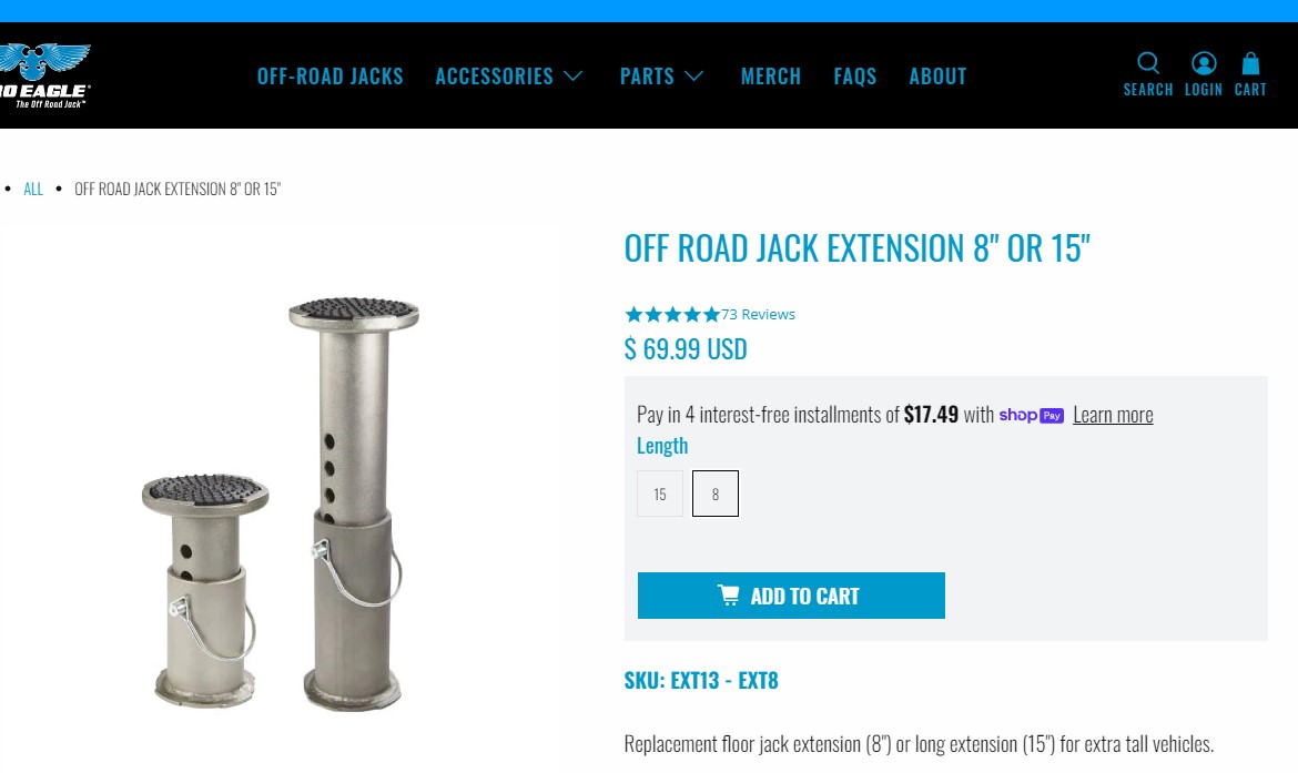

Obviously you understand the issue is that the static height combined with suspension droop can prevent the tires from not touching. Most standard floor jacks dont have enough travel.
For the JACK...you need to either buy something like this
or place a 4x4 on the jack to increase the lift.

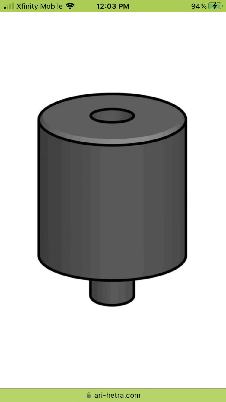

I bought a thick aluminum (?) cylindrical floor jack spacer. It’s about 3”-4” tall and goes in between the jack and the puck that touches the frame. I can’t remember where I bought it, but it wasn’t too expensive (<$50?). The extra 3”-4” comes in very handy.
I’ve attached a pic of a similar spacer.

The extensions that go on top of the floor jack pad look great, just concerned about them keeping their alignment and not tipping. I know that one company sells extensions that screw into their jack stand and those look very stable.
