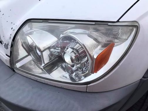

Morimoto D2S 5.0
I'm currently installing and retrofitting Morimoto D2S 5.0 HID projectors in my 05 4Runner. I've read a lot of posts and online videos on how to do it. Pics and info once complete. I have to put the lenses back on and bake in the oven. Be back later with pics.
Just take the time to retrofit projectors and be done.
I put in a Morimoto kit. Its fantastic, greatest upgrade I've done to the truck. Makes long night drives so easy...
