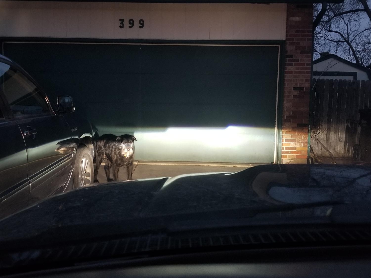

I can explain in one pic why a retrofit is worth it. Keep in mind, this is before proper aiming, and I was just testing output.

How do you know it's going to be out of focus?

I'm not saying that none of the LED's work but part of the problem is getting the multiple sided lights to focus as a beam, they tend act more like a flood light. You could put a piece of duct tape over the top half of the lens and it would still shine in a flood pattern into oncoming traffics eyes, not like the garage picture with the dog

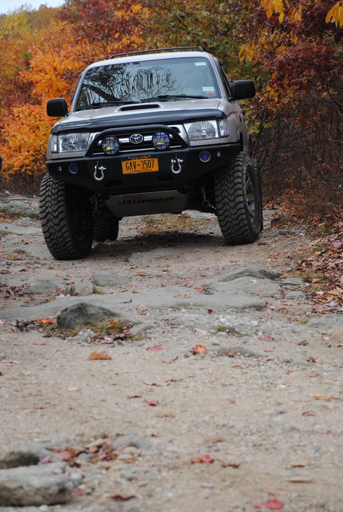

I agree with the others. Get good bulbs for the factory housings & add add some driving or fog lights like PIAA. I can see plenty at night. 4" PIAA's in the bumper & 6" on top.
