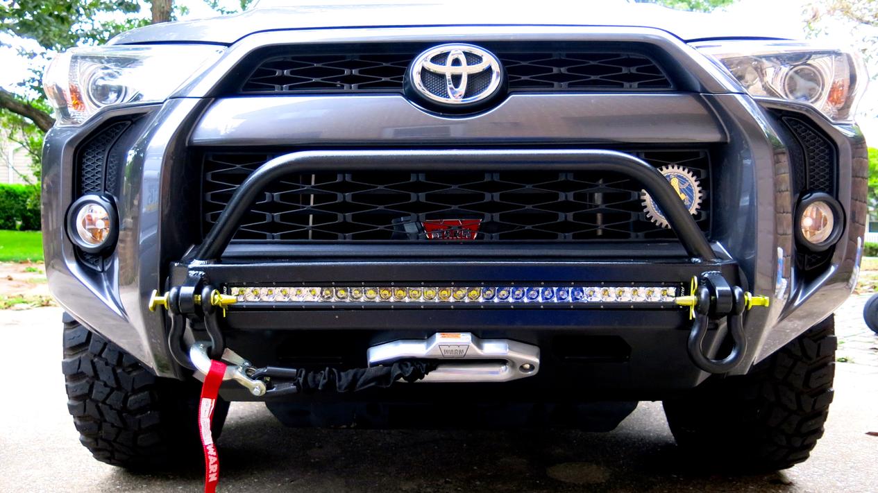

Ok- so I have this SSO bumper with a 30 inch light bar and HID low and LED fogs. The HID lows were the best initial upgrade to my T4R as the stock lows were terrible. The LED fogs were a quick 10-minute upgrade that also added a lot of bang for the buck as very useful in rain and snow in Colorado. Again the stock fogs did not do much. As for the light bar, you can only use it off-road (legally) and therefore it is like insurance, you don't use it often but glad you have it when you do need it. It is an item that needs to be decided when you order the bumper if you want it integrated, like in the picture, unless to attach it to the top of the bumper. As for cost, Rigid and Baja light bars are the best but I put in the lower cost bar by Heise (something better then nothing and still get the look if that is important to you) and it was in the low $200 range which was very reasonable. The Heise bar works fine though I cannot compare it to the others. It does it light up the night well make off-road travel safer and compliments the low HIDs very well as it spots the trail further down than your lows or highs. I also added amber LED Rigids so I can use them in the snow with the fogs and no other lights on which gives me the best of both worlds.

Sorry to go off-topic, but your trim job on the factory bumper with the weather stripping is super clean.
I used a Dremel to cut the factory plastic bumper about 1/2 less than the instructions said and used the supplied "liner" to fit it tight against the new SSO Slimline bumper. Since the plastic bumper has some flex and I knew I could always trim more but not less, this seemed the smart way to install this new front bumper. I was and still am very happy with this setup.

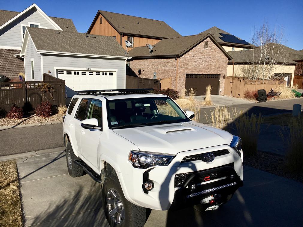

Well finished my install of Aluminum SSO Slimline bumper, Warn Platinum 10K w/synthitic line and 30" Ridig SR2 combo light bar. Remote for winch is AWSOME!!! Have light hooked up through winch remote. Very nice option, still one more outlet on winch. Down the road will hook up ARP underhood air compressor to it.
The powder coat from SSO is top notch!!!
Total net weight gain of 113LBS....May have droped front end 3/4" with stock TEP shocks....Very HAPPY with the whole set-up.

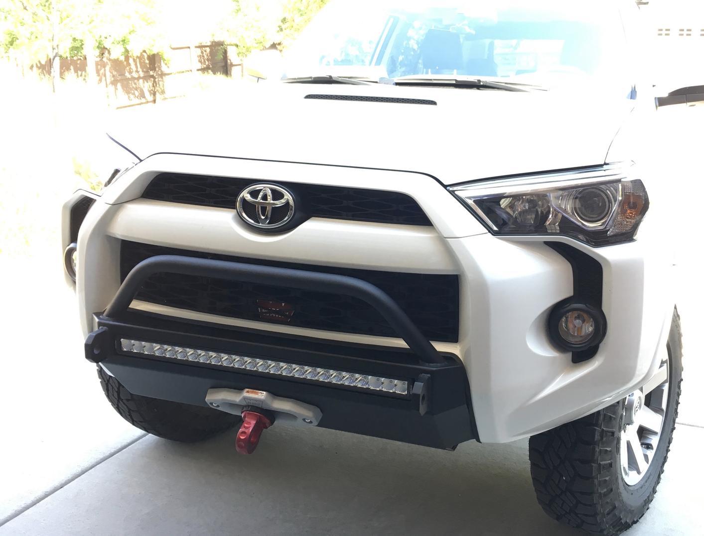

Cut plastic bumper with a razor knife, worked extremely well. Also cut rather close to new bumper and don't seem to have any issues yet. :dancin::dancin:
