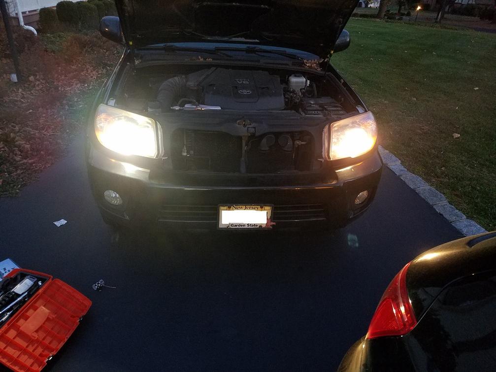

I've installed HIDs & LED's on my Wifes', Sister's, Father's and my own Truck. Not counting the significant increase in light output, better visibility at night, and color temp options, I completely agree, zero return.
The pic below is of my sister's 4th Gen

That looks terrible, and I'm sure you're blinding the crap out of everyone you meet on the road. But hey, you can see, so eff those other guys right? Right?
You do know how to aim your lights.... right? No one is getting blinded. We live in Jersey and if anyone is the slightest bit irritated, its high beams and F-U horns; none so far.
If you don't like the look, thats your choice. Have fun in the dark.

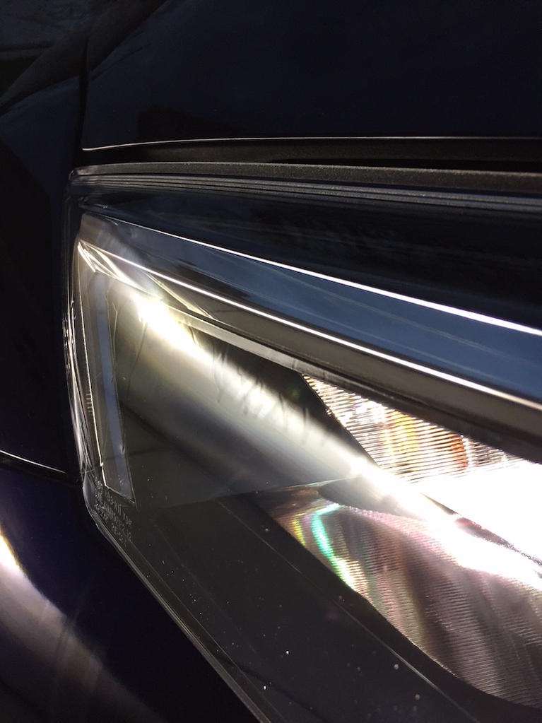

Thats my feeling, 100%. So I came here looking for advice to remove this moisture/diagnose it. The bulb is sealed and the lens even replaced, yet the moisture came back. Letting it sit overnight in the garage you can't tell there is anything in there. When the lights are on for about 10 minutes, it starts streaming.
