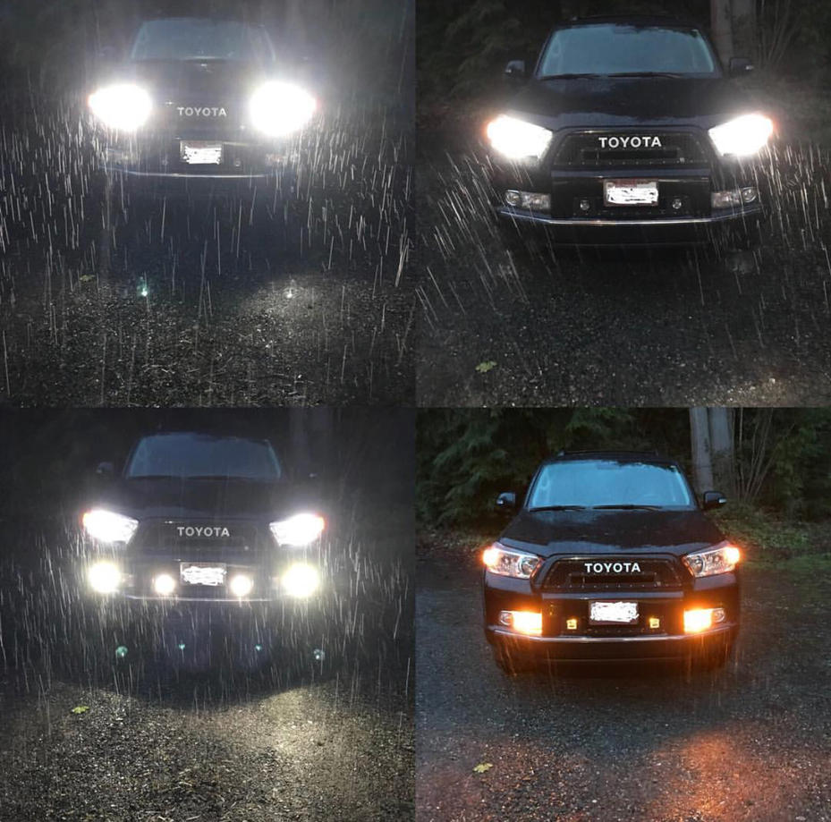

I have all oedro led bulbs from amazon, they are the long stem chip (only manf. Of its kind so far) they are in the hi, lo and fog housings they even match my rigid radiance pods output which is nice.
