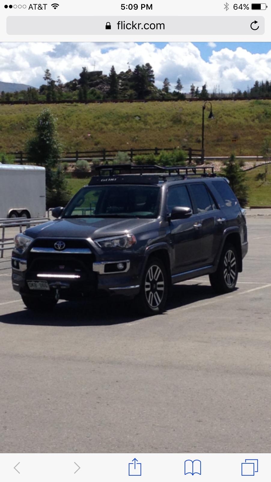

I've looked through archived threads and couldn't find a clear answer, all of the hidden winch mount compose say it is not compatible with a LE, however I believe the frames are identical to other trims, so would it just involve cutting through extra plastic? Anyone have any experience?
someone posted this a while back and it is the bigfoot to us limited owners.

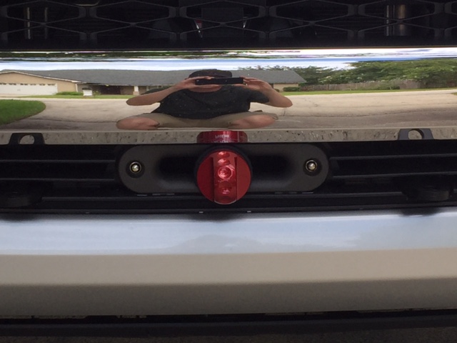

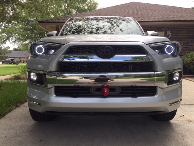

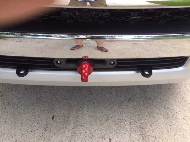

I went the BudBuilt and it required a bit of tweaking but came out pretty good. I went with a Warn ZEON 10-S and Factor 55 fairlead and Prolink.

Yeah... but what lights are those, and do you like them?
The fogs are the LED Toyota DRL/fogs and if you mean the halos, those are also set up as DRLs. The headlights are bi-xenon from Kustom54 and I love them. My BMW has adaptive bi-xenons and I was shocked at how poor the factory lights were on the 4Runner by comparison so it was the first thing I changed. I can never use halogens again...
Are those recovery points part of the winch mount? I don't see them in the pics on Bud's website.
Yes they are and Bud told me that was the 'old version' pictured on his site. If you order from them, make sure you check your invoice prior to them shipping and make sure they have the correct year and model.

Looks like a great way to add front recovery points to a Limited, even if I don't get a winch for a while. The only other option I've seen (Treaty Oak) puts them really low.

Yeah, obviously it requires some cutting of the front bumper but it wasn't as bad as expected. It maintains a relatively factory look but provides more functionality.
