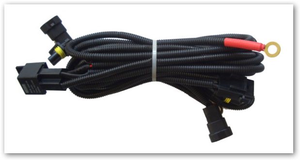

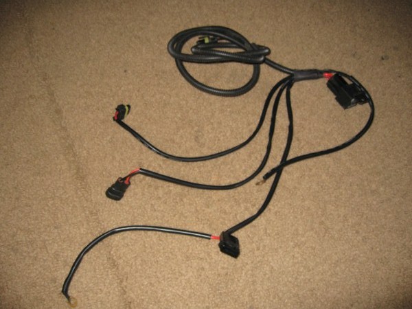

Best practice when using HIDs is to use the wire harness which includes the relay and fuse.
The HID's i got are apparently are "plug n play". Should i be purchasing a new harness, or just the relay wires? Are the relay wires universal, or do i need to ask for a specific one? what should i be expecting to do when i purchase the relay wires? How do you install them to the ballast? sorry for the million questions, i'm just sick of not being able to install them! haha Thanks

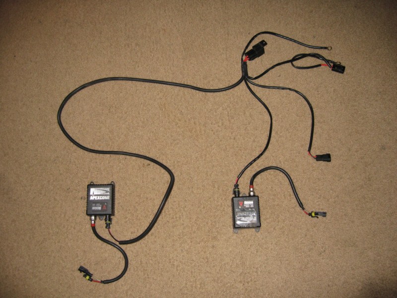

i have set in the back of my 4runner now, Let me take some pictures of how it will link together, pretty simple (universal now-a-days) plug and play. I'll Post the pics later tonight.
Thanks a lot, hopefully this is the solution, and i can finally have some fogs!
wire harness

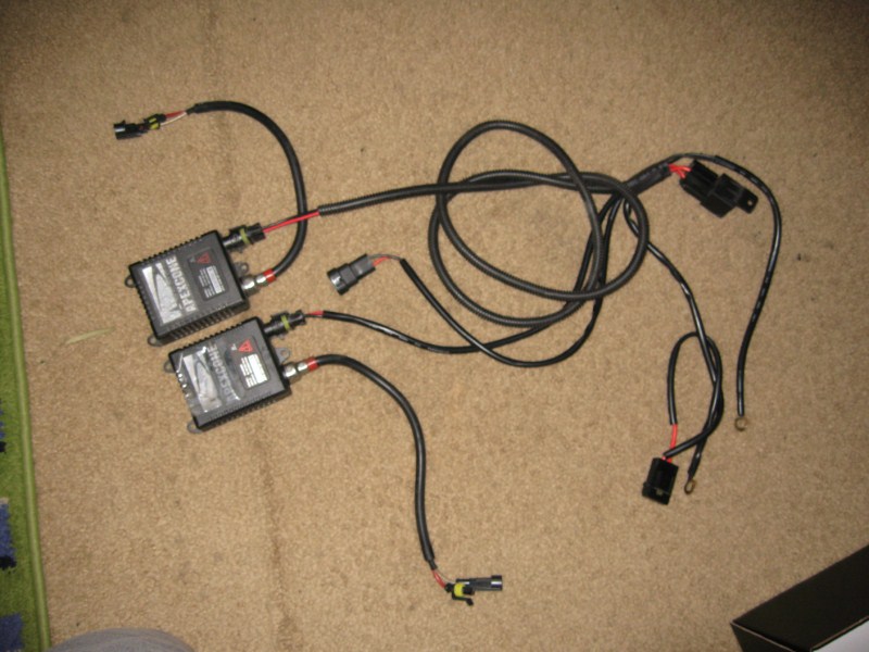

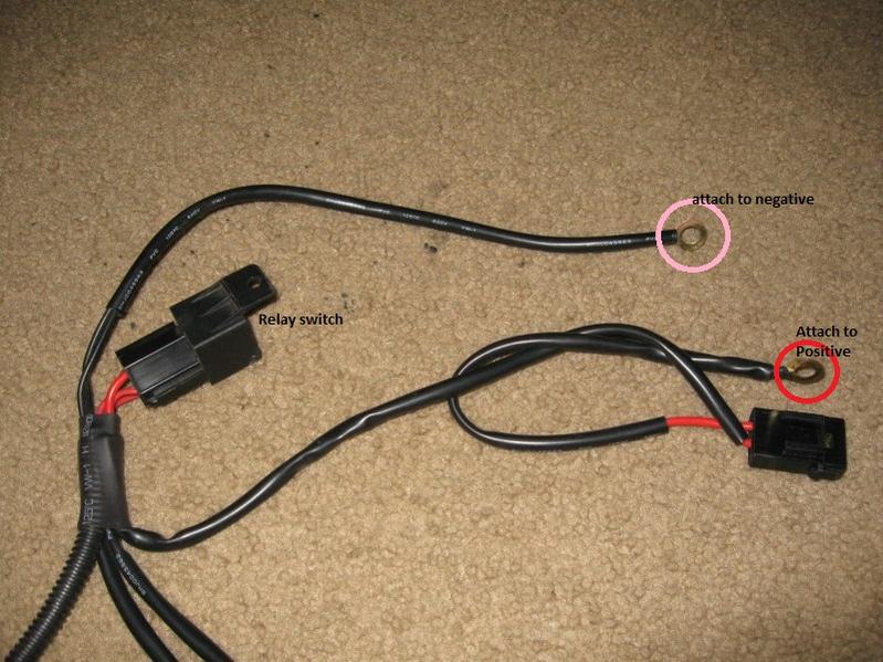

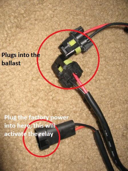

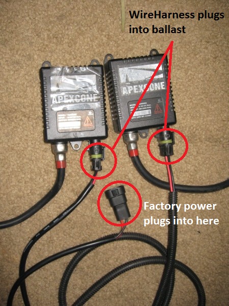

Here are some pictures of the harness plugged into the ballasts and some explanation of the plugs. Also threw a picture of my HID projector and Fog output. Gotta love HIDs!!! where did you get your HID from?

no problem. the picture shows my 35 Watt Low (4300K color) and Fog (3000K), but just upgraded to 55 Watt (6000K) over the weekend (no pictures just yet). The pictures i took of the harness and ballast are from my 35 Watt Low setup. Never had any issues with flickering or powering off after awhile, when using the wire harness. I had similar setup on my 95 4runner. I had issues at first when i tried powering the HIDs on the factory wiring. All i can say is the harness solved all the problems. good luck.

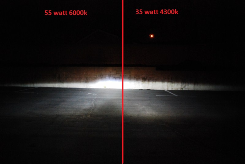

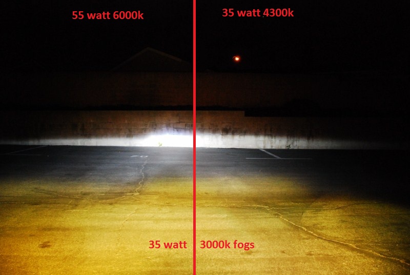

35 watt 4300k vs 55 watt 6000k
Ok so finally went and took some pictures. over all the 55 watt definitely puts out a lot more light, but more noticeable in the hot spot or center, not so much on the outer flooding area. On dark streets, alleys, and trails these light are gonna light the path for sure.

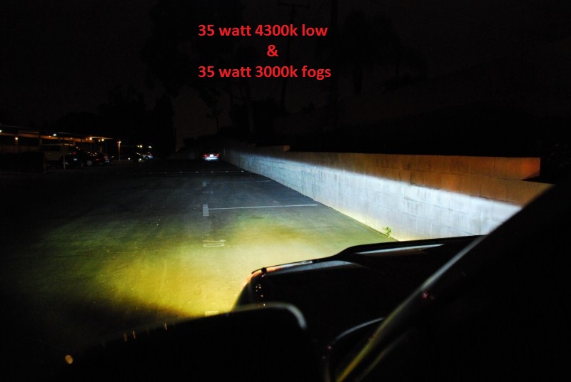

35 watt setup all around lows and fogs

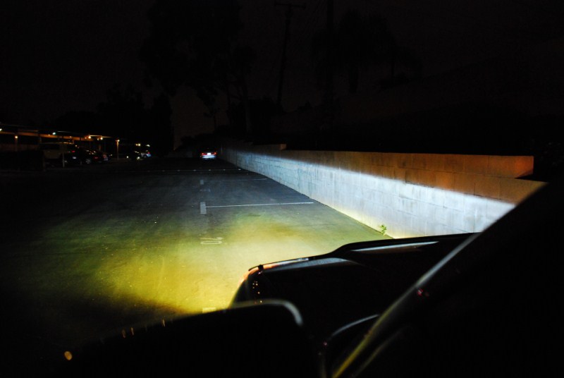

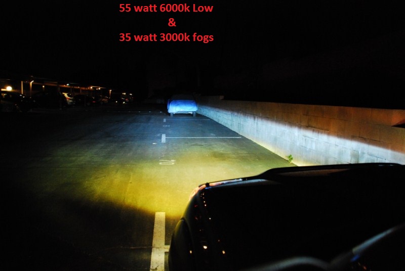

55watt lows and 35 watt fogs

55 watt on the left, 35 watt on the rights, 35 watt fogs, you can see the 55 has a brighter hot spot
