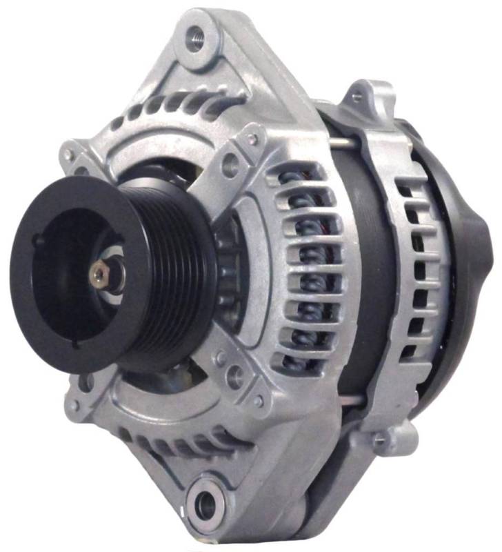

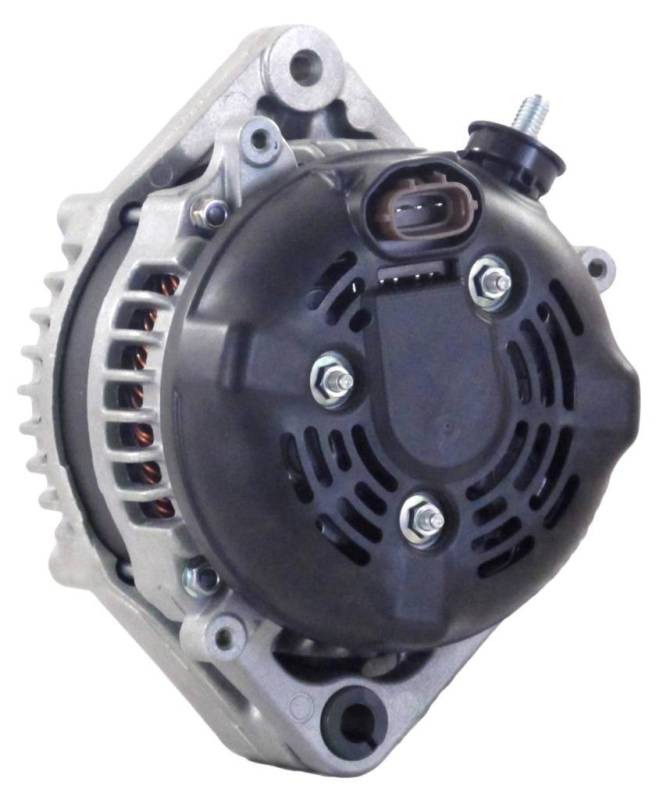

Found a 150A alternator for a John Deere that looks like it would work. Only $200. Has anyone tried this one?
New 12V 150 Amp Alternator John Deere Tractor Re186320 Re257541 1042103920
