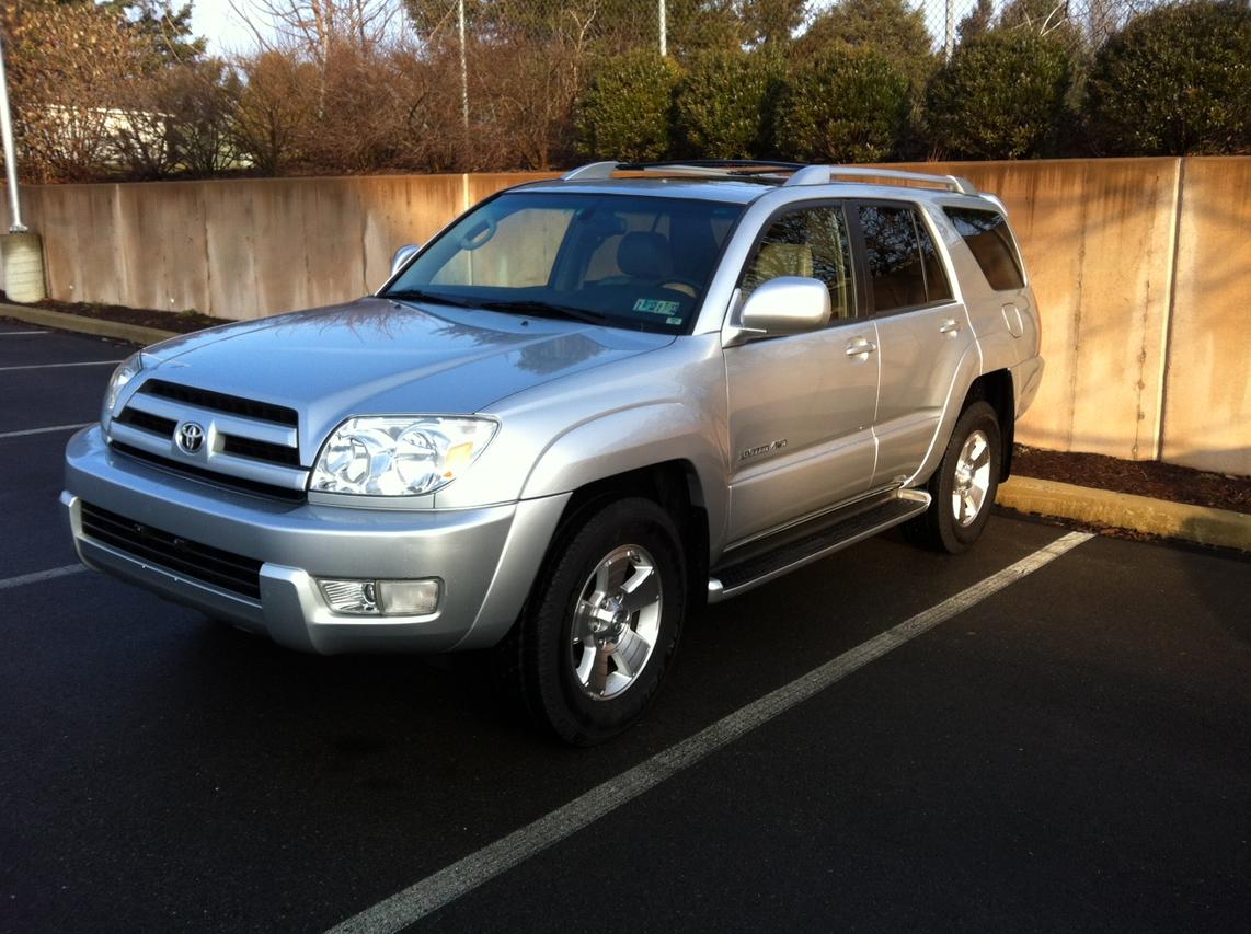

Hi,
Just picked up my 2004 4runner and the owner said he put in mid grade (89) gas.
I wanted to know if changing now to regular (87) would be bad for the engine. The car has 119,500 miles? Should I just keep putting in mid grade gas?

Nice Limited.
I ran premium for over a year after I first got my truck, mostly because gas was pretty cheap. I now run 87 and have done so for the last 25k or so. I notice essentially zero difference and the manual says 87 is g2g. Wikipedia lists 3hp and 12 ft lb of torque increase when comparing 87 and 91 in the 1gr-fe V6, both at RPM's I rarely see. Bottom line, you wont hurt a damn thing with 87, your engine was built for it. You will find people that swear by premium, mostly for peace of mind.
