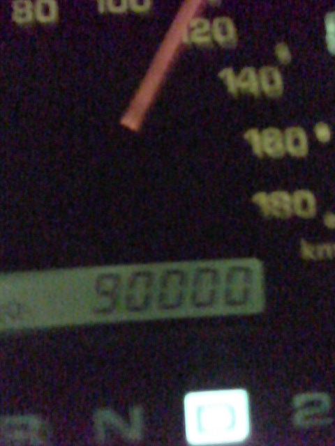

Hello everyone,
My 4Runner proudly turned 90,000 miles today and now I'm wondering what services are required at this mileage.
Timing belt and fluid flush is what I've seen in search so far.
Is there anything specific that might be omitted in the 90k service manual that I should consider?
Thanks.
PS. Note to self: taking a camera phone photo while driving on the highway is not one my brightest moments, I know.
