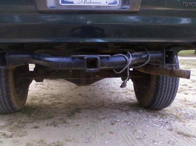

Not sure if it would fit with your bumper but I cut and flipped my receiver upside down. Can't say if will work with your bumper since I removed my bumper beforehand. However, it looks like that may work.
Here's a link to get an idea of what I mean and whether it looks like it will work for you. It brought the receiver up to between the frame rails.

id do this, and if there isnt enough room, then notch out the bottom of the bumper to make room for the 2" receiver...
Just took another pic for the hell of it today so you can see if it looks like it'll work for you.
