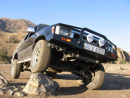

I just thought I'd show off with my home-made bumper.

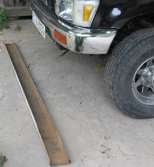

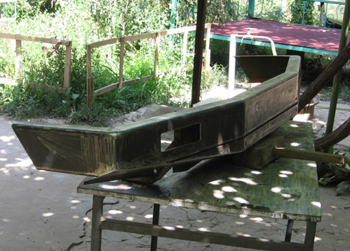

I used a U-profile, 3mm thick. It wasn't tall enough, so I had to use some angle-bar at the bottom of the bumper.

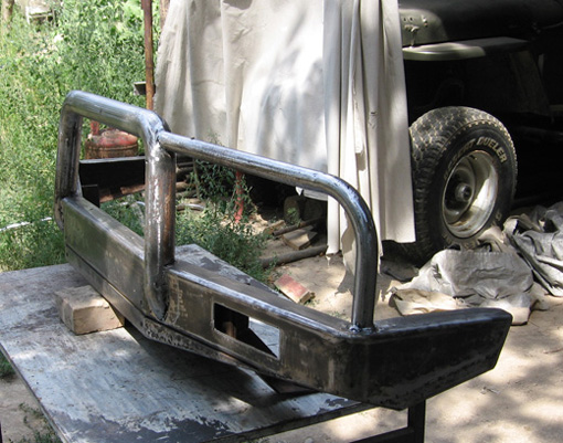

I bent the corners, welded tubing. I don't have a tube-bender that would bend thubing this thick, so for the center one I used bends that they sell. The corner ones I had from somewhere, I just used what I had. I think the corner ones should be a little thicker though.
I also used sheet metal to cover the underneath of the bumper.

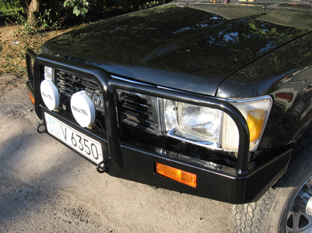

After some body filler, I sprayed it with primer and then black from spray cans.
Right now I'm working on a bumper for my friend who has a Ssangyong Musso.
here's more pics (i don't know how to put them in one post)
Great looking bumper !!
Always like to see some home-brewed Fabrication skills !!
Time to fab up a rear one right ?
Peace,
Adam B.
Excellent. Looks very nice.
You have some skills, that can I tell ya. ;)
Been thinkin' of doin' something similar with my front bumper, but I think I'll start with the rear one first. :)
