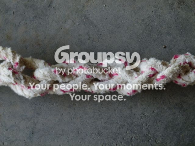

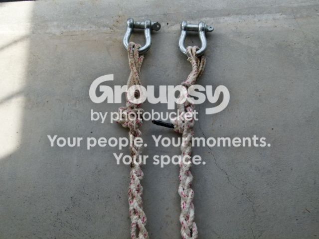

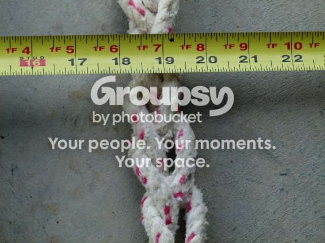

I made this and it's usually what I carry. It has its' pros & cons. Got ~ 30'.
Cool idea. That looks like old 11mm static climbing rope, but I can't tell for sure. Just FYI, when it's braided like that you probably don't get 3x the strength of a single strand because bends like knots and braids decrease strength. But it probably increases shock absorption/stretch and makes it neater to pack up. Note that "static" climbing rope still stretches a significant amount, just not at much as dynamic climbing rope.
