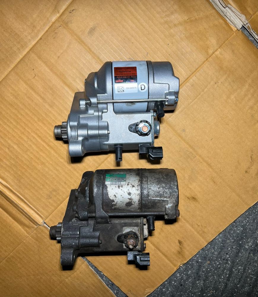

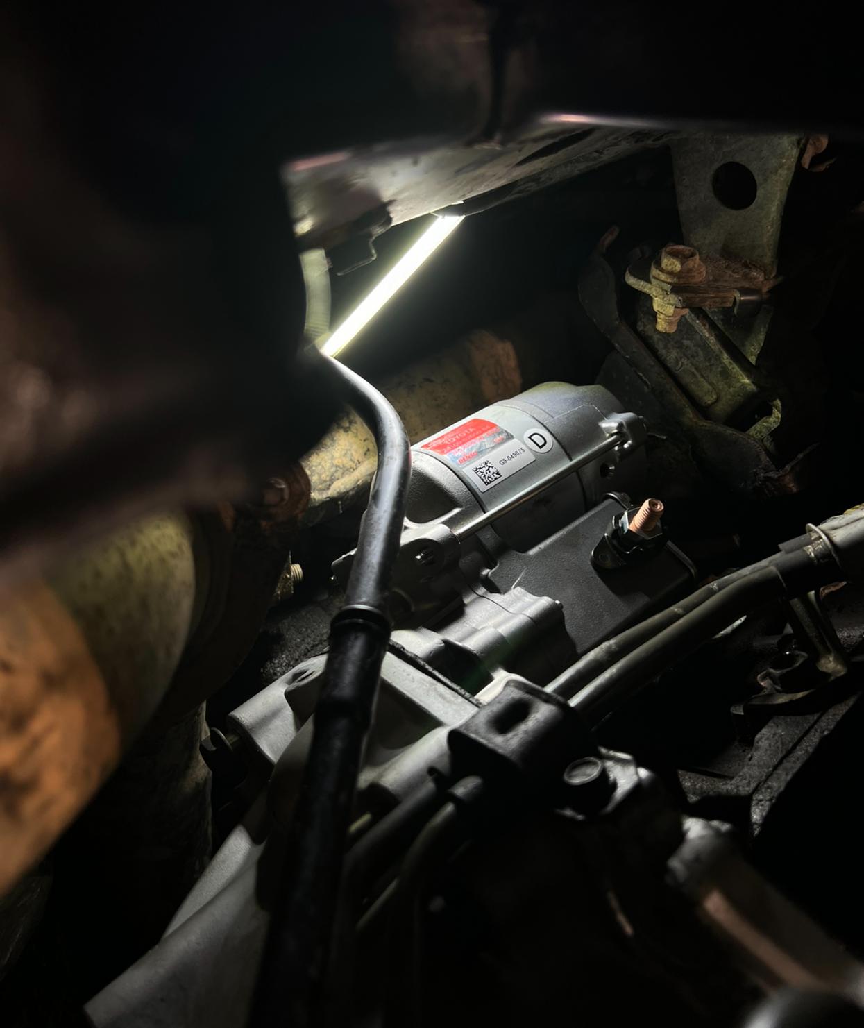

Update, kind of.
Replaced the starter with an OEM denso, cleaned the connections to the starter, replaced the starter relay and STILL have the same issue.
Simply put, if I drive and get the truck to temp, stop (think running in to the gas station for a drink) and try start the truck again, nothing. Sometimes I’ll get a single click, usually nothing. Then, once it seems she’s cooled off enough it fires up no problem. Heat, it seems, is the constant here. If I drive around the block and don’t get to temp, it’ll fire right up after I shut it off.
What else should I check now?

Fuel pressure or vapor circuits could cause the engine to crank over but not fire up, but not a 'click' situation. There's a problem with your starter circuit - relay or wiring. That's all I got for you, something might have been damaged during the transmission repair, especially if they tried to yank the transmission out and forgot to unbolt the starter.
