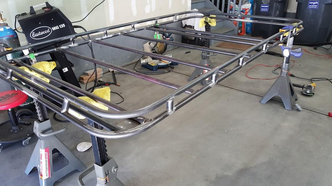

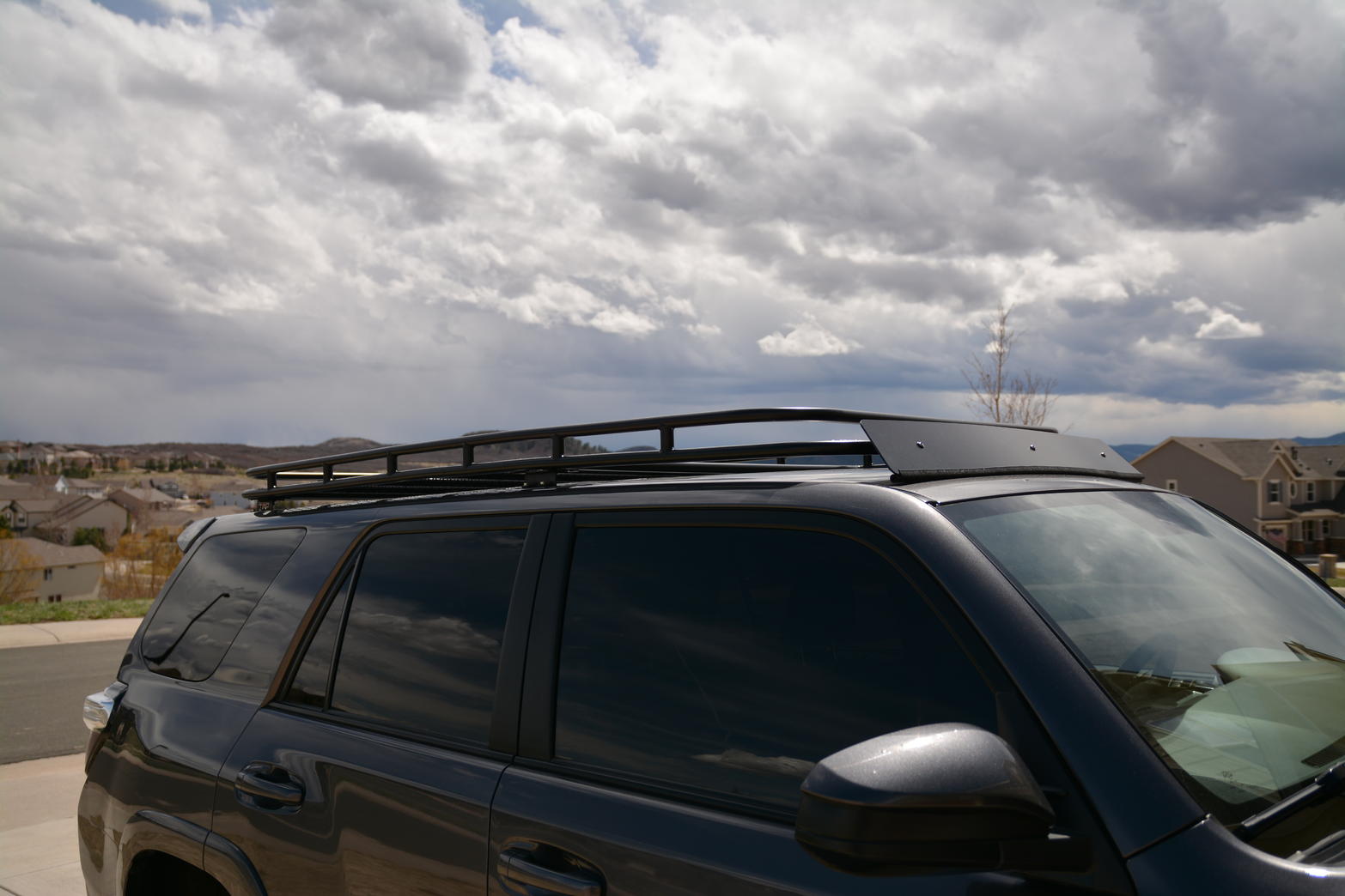

I built mine as well. 1" HREW tubing. Just need a tube notcher and bender. Not too hard, just very time consuming. Check out my thread for more pics.
