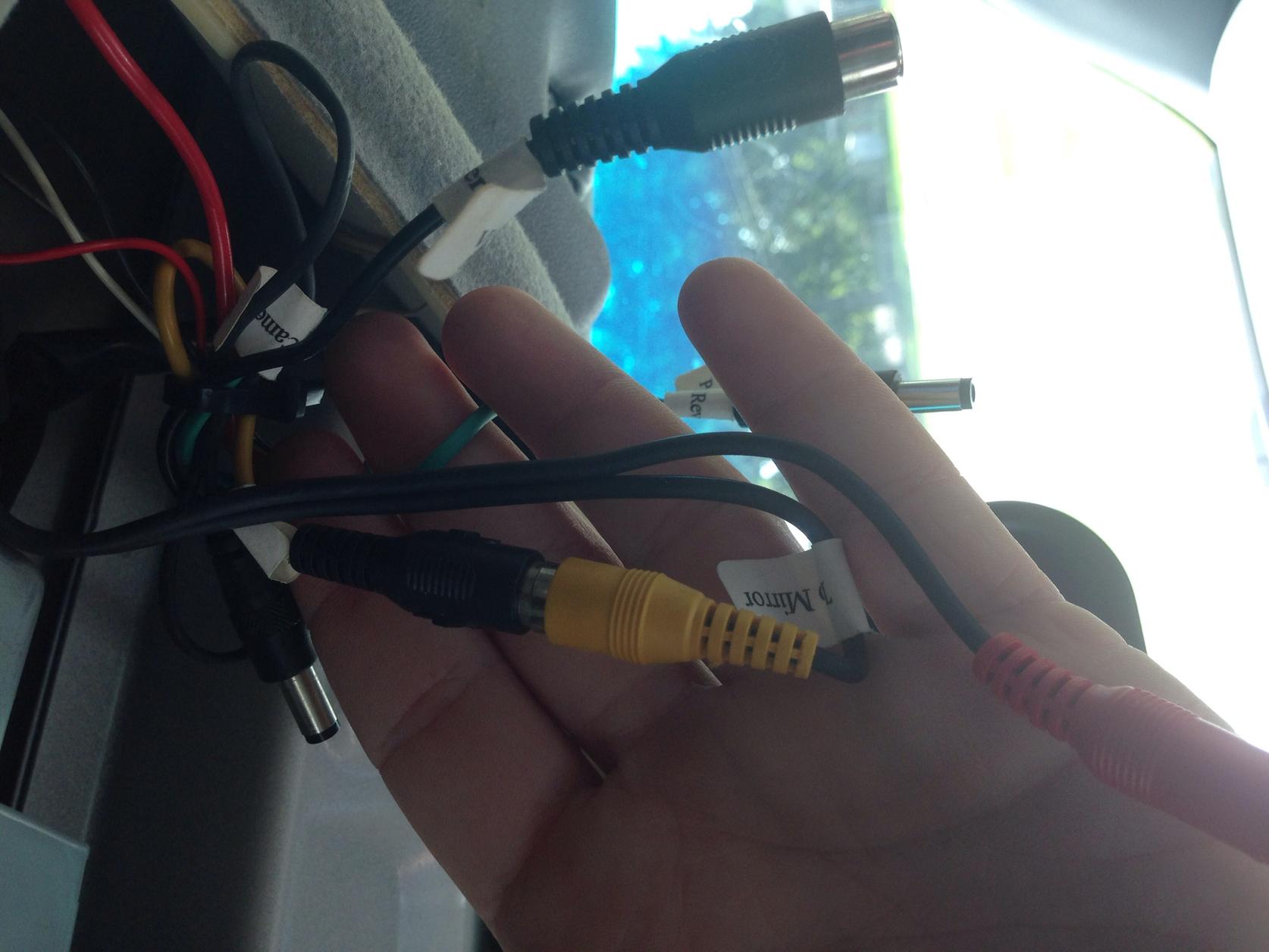

1. Back up camera issue. I pulled down the dome light/sunglasses holder piece. Inside was a bunch of wires which said reverse camera/inside camera/etc. only 2 plugs were plugged in. Approx 3-4 were not. I'm assuming this is my issue. However, I can't find the ends that are supposed to plug in. Can anyone send me a pic of what wires are supposed to go where?

Congrats on the new ride. You didn't provide much info in your first post which is probably why no one responded. With electrical and wiring issues it can be a bunch of different things and we're just on a computer, not looking at the truck with you!
So - pictures pictures pictures! Take some and post up so we can tell what plugs you're talking about. The more details and information you provide, the more we can help out.

Thanks guys. I will go and take a picture of wiring for the rear camera. I will also try the 'reset' for the moonroof. I did search but mainly just found water leak issues. I've been on forums forever so I know to search. But also when you are on bigger forums, threads seem to get lost or just overlooked with hundreds of threads with it.

Picture of wiring. Here's a breakdown of the colors and what they are.
Green - Power 1 Reverse Camera
Red - doesn't say
Black - Video 1 Reverse camera
2nd black - Power 2 Interior camera

I got everything figured out.
1) sunroof. Took it to a local car shop who's been in business a while. They found out that nothing was broke. However, the slide on the driver side came out of sync with the passenger side where the wind reflector goes down. That resulted in the sunroof to come off track. They put it back in and greased it up. Works like new now.
2) since the liner was removed to fix sunroof, I had the perfect time to go look at all the wires for the rear camera and DVD system. Apparently both were aftermarket systems so the wiring was all over the place. I think they had an aftermarket stereo to help run everything. However, wires were missing, cut, and unplugged. I ended up taking all extra wires out.
