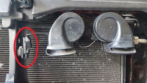

I was messing around with the ambient air temp sensor, and one of the horns started working....??? Any idea why this would affect the horns? If I replace it, should both horns start working if in fact that is the issue somehow?
