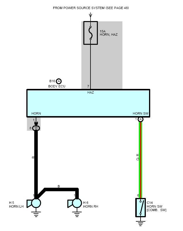

Well, according to the FSM, the pad is just a normally open switch, so I think you should be able to test it with a multi-meter.
I wouldn't think it would be the pad. If the pad has an intermittent failure, then I think you would hear a sputtering horn more than a full-on. I would think it is an ECU issue.
I couldn't say if it is a bad ECU or if the ECU is receiving some bad stimulus to activate the horn.
Test the pad before you go replacing anything. It looks like you can tap the ECU lead for the wheel switch and ground for the test.

ECU is the vehicle computer.
If you pulled back on the steering wheel housing and it shut off, then maybe the issue is with the steering wheel housing. It could be stuck halfway down or something like that. I think you are going to have to get in there and check it out, or test the pad like I said.
If you touch the steering wheel, pull the airbag fuse first. You don't want to set it off while you are working on it.
That may not be good enough. The FSM says to turn key off, pull the negative battery cable, and wait 90 seconds for the reserve power cap to bleed down before working near any SRS component (and I will add: ESPECIALLY IF YOU ARE CHECKING RESISTANCE).
I wonder if the "clockspring" cable in the pad could be a suspect. Usually they fail to an open horn circuit, not to a short, but who knows? It only has to short to ground to set off the horn (true for anywhere along the wire between the pad and the B-ECU).
Anyway, read this before messing around in there. If it's still good, you don't want to break it.
Here's a suggestion--pull the plug out as described in the link and leave the clockspring disconnected. You will lose the horn, airbags, and cruise control. Reassemble leaving plug loose and replace horn fuse. If no midnight horn, problem is indeed pad/airbag assembly. If horn still goes off, then clockspring to B-ECU wiring is bad, B-ECU is bad, or wiring B-ECU to horn is bad. This last is extremely unlikely, as it would mean picking up stray key-off 12V+ somewhere and not blowing a fuse. Also, you haven't had a recurrence with the horn fuse pulled, so that means rogue current is passed by the B-ECU and not picked up by the wiring via some short.
