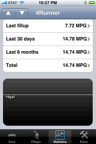

So right now, I am getting 14.7 mpg (I have a thing on my iPhone called Tankbuch, very good) and I hope that will be back to 20+ soon.
A funny thing -- I get better mileage wth ECT power on. 7-10 mpg w/o ECT, 14-15 w/ ECT. Ha, I like ECT better anyway. The thing is so slow without it... it just might be amazingly better once this shit's done with. Only reason that w/o ECT I get so little is probably because im flooring it half the time trying to get the ****ing thing to move with traffic.
This pic is me running with ECT always on, aside from the last fillup where I decided to shut it off and see the outcome.
