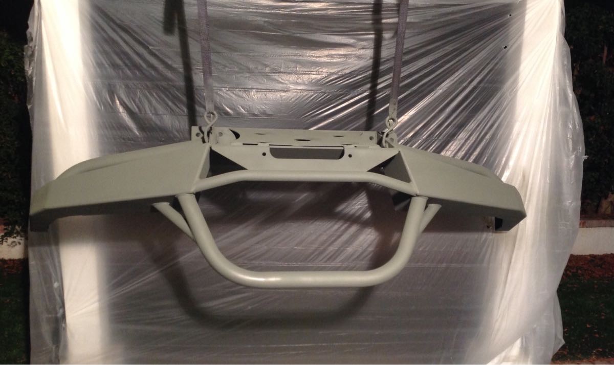

This is about the exact same method I used and thought it came out great (went with semi-gloss). I don't think I would change anything if I did it again.
I like powder coating but it's hard to touch up scratches. Shrockworks would have powder coated it for an extra $100 (well worth it) but I'll probably be getting my rear bumper & sliders from different companies & I want the Black's to match on everything.
I had mine powder coated for $50 from a lighting company.
Thanks for the reply.
Do you have a pic of it finished? Is that the Duplicolor self etching green primer?
What semi-gloss black did you use? Did you use a clear coat?
Thanks
Edit: I went through your photo's & your truck & bumper look great!
Thanks
