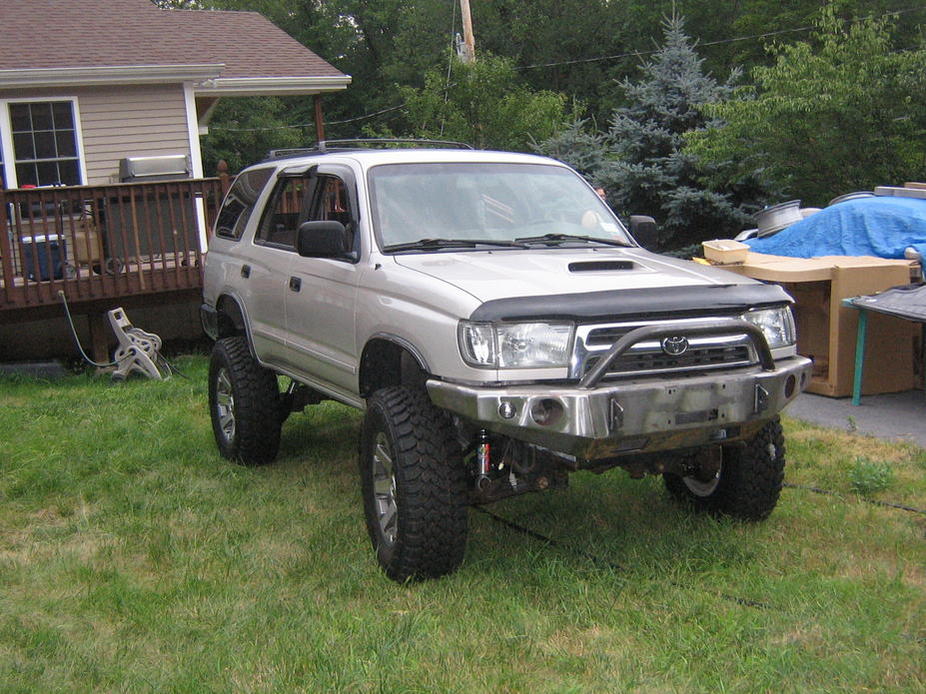

I test fitted my bumper over the weekend (see pic) & need to bring it up another 1/2". I have a little play & if it's not enough I'll enlarge the bolt holes a little. Mine was built for a 1" body lift also.

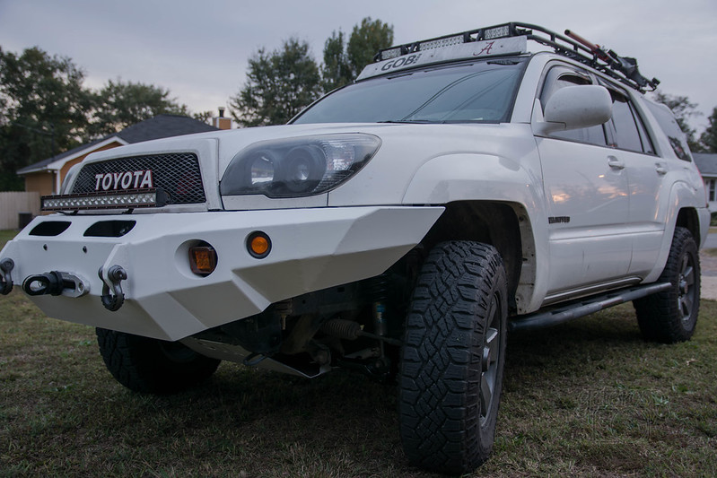

Thanks! I used spray paint from AutomotiveTouchUp.com, it was a good match but wasn't cheap, about $25/can plus shipping. I used several layers of cheap white first to save on the expensive stuff but still needed about 2.5 cans to get enough coverage to take away the blue tint from the cheaper white, then followed with ATU's clear coat, it was only $8/can.
Looks like a good fit to me, too close and it'll rub on everything, mine has about the same gap as your picture and it rubs a bit on the fenders.
