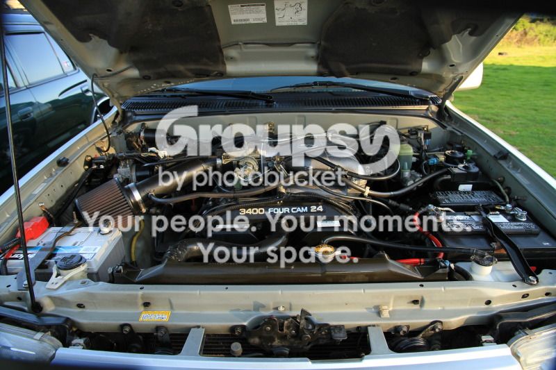

DieHard Platinum or Odyssey hands down. Here's mine. P-5 Group 35

IMG_4754.jpg~original
Ive been running the die hard platinum for a while now on fridge duty, which means it gets really drained sometimes before being charged back up. Right now it is also helping to start the truck since the Oriliey's POS (stock location) is getting weak. Yes I will be replacing it with the same die hard. They are pricey but for the piece of mind, quality and warranty you really can't go wrong.
