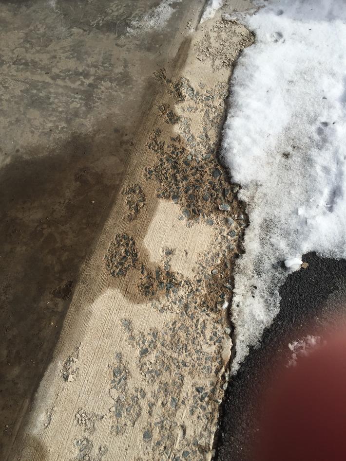

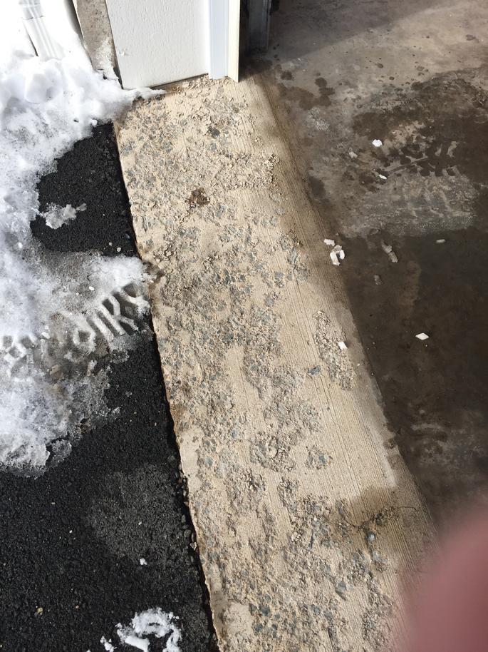

Hey everyone,
What is the easiest way to repair the entrance of my garage? The builder obviously did a shitty job laying he concrete and it's been flaking over the last couple of winters. I'm sure driving over it doesn't help either.
Are there any quick cement repair kits for a job like this?

The portion that extends beyond the garage door has a rough/textured finish with fine ridges. Would I want that part to be polished/smooth, or is it just an aesthetic thing?

I'm just worried about it crumbling more. As you can see, in th first picture, the gap between the cement and asphalt and wobbly so to speak as a result of stones breaking away from the concrete base. I just don't know how much more it will go. Thanks for your help.

GO to Lowes, get some epoxy made for this, mask you a line right across the door opening and just do the damaged part. No real masonry fix besides chipping it out and re doing it.

I'm going to piggy back on 1E a bit here. If this was a bridge deck, we would saw cut <1" (depth) around the damage, chip it out, use a structural epoxy on the edges and fill with high strength, rapid set concrete. You'd do well enough to use something like this on the damaged areas, and if it makes you feel better, run some epoxy or sealant (look here) along the edge where the asphalt meets your garage's concrete. Make sure you pressure wash it all first to clean out any salts, oils and debris. Since you have a lot of spalling, sealing the edges of the patches may not be realistic, but it would help with the longevity of the patches.
If you're wondering, it looks like the concrete spalled because they (the builder) dumped water on that "ramp" area to keep it more workable and get the fines to float up so they could get you that textured finish. At the end of the day, you can't "fix" bad concrete (only long term fix is to cut out and replace), so you may have to maintain the surface repairs every few years in the future.

Thanks guys, that's awesome. I'll look this up!
As others have pointed out, that's called spalling and if you want to prevent further damage you can do something as simple as using a self-leveling concrete repair product from a company like sakrete. I had the same problem with my driveway and my repair has been holding fine for 4+ years with no additional spalling taking place.
